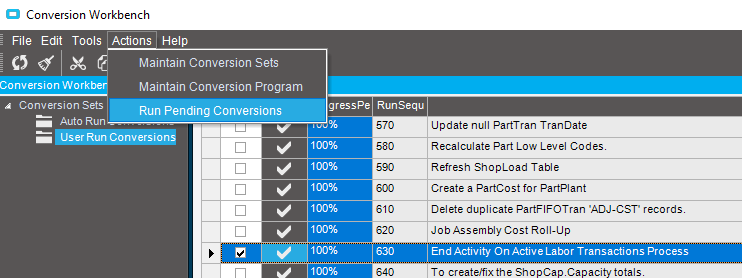

sorry Art, you logs me at the conversion workbench, User Run Coversions, I dont have an Evd Activity on Active labor, still running into this issue

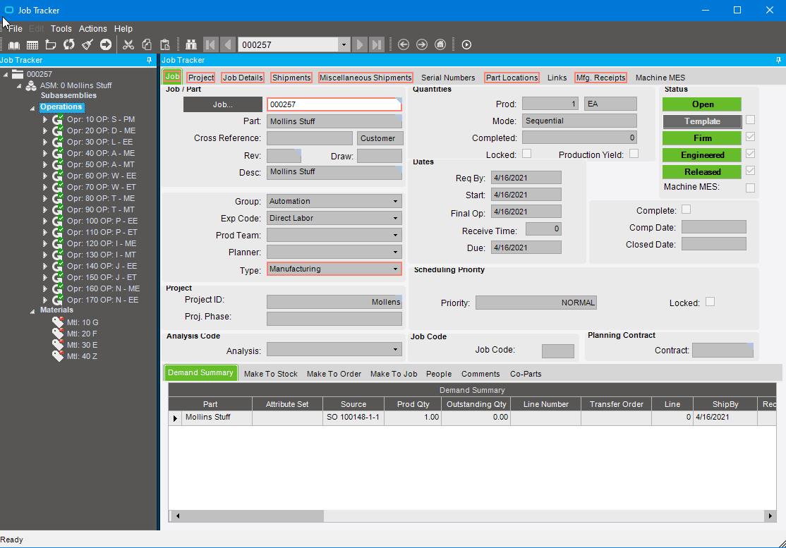

You can look in job tracker under the labor details and look for ActiveTrans = true or Labor Status = E (you want A) That’s usually how I find them. Then just go to time and expense and fix from there.
You should log in as system manager.
Conversion Workbench can be found in System Management > Upgrade/Mass Regeneration.
Or, you can do Search.
Select User Run Conversions. Select 630 - End Activity On Active Labor Transactions Process.
Goto the menu Actions and select Run Pending Conversions.

maybe i am missing it, where is labor details

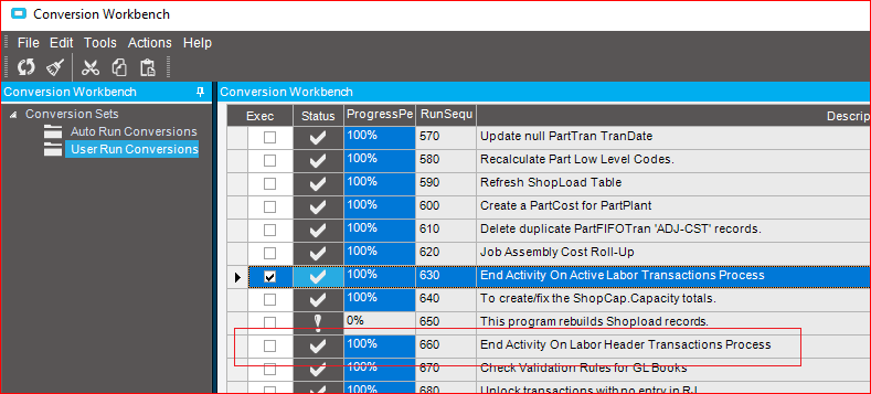

I just did all that, and selected both 660 and 630 since you mention both in the picture and got this, so I wonder at any point, does Epicor become usable?
Program Ice.Services.Lib.RunTask raised an unexpected exception with the following message: RunTask:
System.FormatException: Input string was not in a correct format.
at System.Number.StringToNumber(String str, NumberStyles options, NumberBuffer& number, NumberFormatInfo info, Boolean parseDecimal)
at System.Number.ParseInt32(String s, NumberStyles style, NumberFormatInfo info)
at Erp.Internal.Conversion.CVJC0078.convertData() in C:_releases\ERP\ERP10.2.700.0\Source\Server\Internal\Conversions\CVJC0078\CVJC0078.cs:line 62
at Ice.Core.TaskBase`1.StartProcess(Int64 instanceTaskNum, String outputFileName) in C:_Releases\ICE\ICE3.2.700.0\Source\Server\Internal\Lib\TaskLib\TaskBase\TaskBase.cs:line 83
at Ice.Hosting.TaskCaller.InnerExecuteTask(IceDataContext newContext) in C:_releases\ICE\ICE3.2.700.10\Source\Framework\Epicor.Ice\Hosting\TaskCaller\TaskCaller.cs:line 117
at Ice.Hosting.TaskCaller.ExecuteTask() in C:_releases\ICE\ICE3.2.700.10\Source\Framework\Epicor.Ice\Hosting\TaskCaller\TaskCaller.cs:line 59
at Ice.Lib.RunTask.BpmFriendlyTaskLauncher.Run(String sessionIdPrefix, IceContext db, Action taskRunner) in C:_Releases\ICE\ICE3.2.700.0\Source\Server\Services\Lib\RunTask\BpmFriendlyTaskLauncher.cs:line 63
at Ice.Services.Lib.RunTaskSvc.InnerRunTask(Int64 ipTaskNum, Boolean suppressTransaction) in C:_Releases\ICE\ICE3.2.700.0\Source\Server\Services\Lib\RunTask\RunTask.cs:line 454
