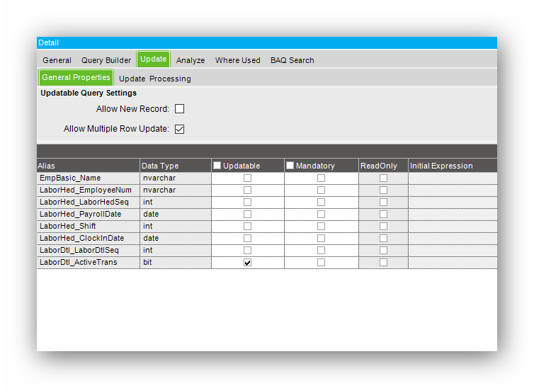

We had an updatable dashboard in E9 we used for this purpose. It changed the LaborDtl.ActiveTrans flag from true to false so the record was editable in Time and Expense entry. The supervisor would then edit as needed and then Submit the record. We don’t use auto-closing, but doing the bare minimum in the dashboard to make the record editable (ActiveTrans = false) and then doing the majority of the changes including submission in T&E seemed to work for us.
I don’t have the E9 version still, but here are the update settings for the updatable BAQ behind the uplifted dashboard.
