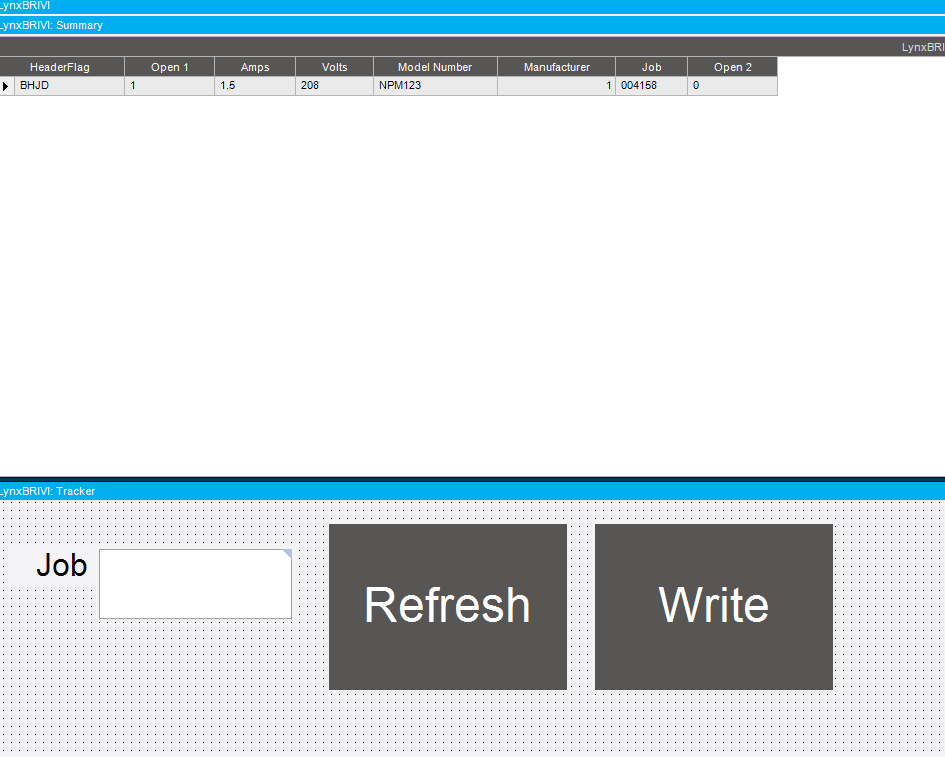

Code to select a field after a button is clicked?
Currently the “WRITE” button writes the data in the grid to a csv, then it nulls the job num field to the left. I want to not only null it but then also select it for the next entry.
I’m not sure the terminology…select, highlight, target, activate, whatever.
I want them during the process to not have to click the write button and then go back and click on the field to enter another job. I want it to pop right back to targeting the Job field. I understand how to use the code and where to put it, just not sure how to write it.
