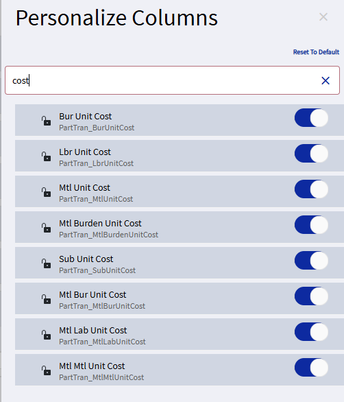

Missing Fields
ExtCost
Bur Unit Cost
Lbr Unit Cost
Mtl Unit Cost
Mtl Burden Unit Cost
Sub Unit Cost
Mtl Bur Unit Cost
Mtl Lab Unit Cost
Mtl Mtl Unit Cost
I just confirmed it’s the same problem. I had disabled the BPM that fixes it (see Column not showing in Kinetic grid/personaliztion, is in data view - #12 by mbayley) but if I enable it, all those cost columns magically appear in Job Status / Part Transactions.

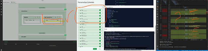

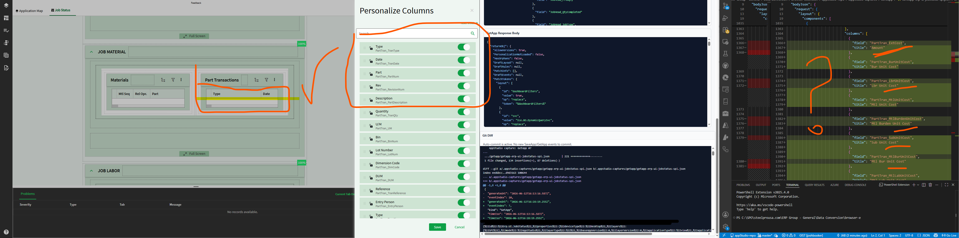

AppStudio just added all currency fields to the top of cols collection (left-most) upon SaveApp. All I did was personalize columns (no currencies in the list) > save layout > saveApp > preview
definitely has a mind of its own. 26.1
edit: to be fair in the surrounding session mayve been forced toany of or all of the below once or more: reload app studio, delete personalizations, messed with show filters, redone the personalize > saveLayout a couple times to make it stick, so who really knows what baseline repro is on any of this…
