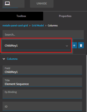

In 2022.2, when in Application Studio you can click the 3 dots (kebab) at the top right of your panel-card-grid and choose personalise columns. From their you can reorder your columns and it will stay in the layer.
Yes done that too. Works well.
If that works for you, then great! That’s how it’s supposed to work. I was never able to get it to actually behave that way in the browser on version 2022.2.7. :woman_shrugging:t2:
