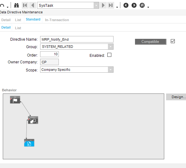

Looking at my screenshot begs another silly question. Is it enabled?

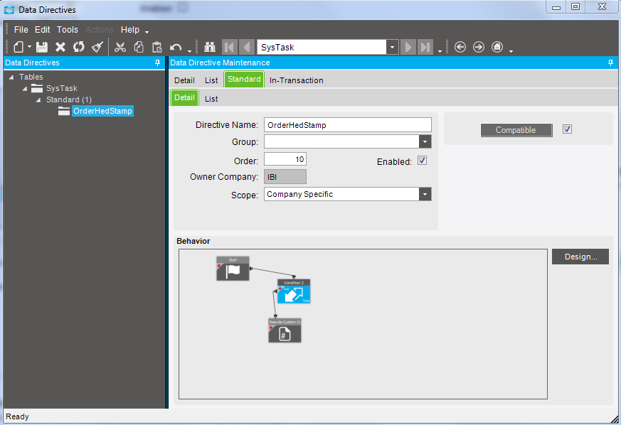

Can you screen shot your directive like I did above?
Sure, here:
And with NO condition, it would not fire?
