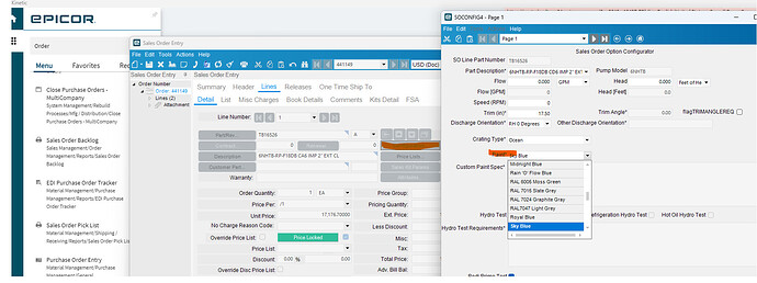

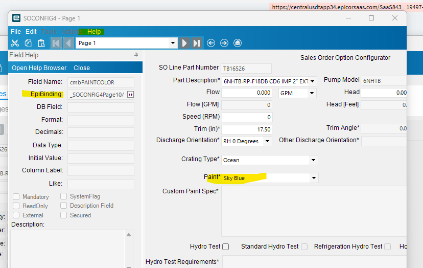

We are looking to add a Paint Color from Epicor Configurator to Sales Order Detail.
We need to use this field in other Dashboards for reporting purposes?. There is no technical details anywhere on the field help. Anybody here know how we can approach this?

Your particular configurator(s) copies all of the details entered into the Order line comment fields, so if you are simply needing to create a dashboard that filters on a paint type, then you could set the BAQ up with criteria on that field using LIKE and paint name (.e.g. OrderDtl.OrderComment LIKE ‘%Sky Blue%’ ), then include that comment field in the dashboard.
@d_inman This is exactly the information I was looking for. Using LIKE %xy% on my calculated field gives me the data that we need.
