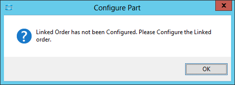

This is the error that we get when we try to Get Details on a Job where the Sales Order Line configuration is at an older version number than the Configurator:

I hate to be the bearer of bad news, there is no automated process, unless created with toolset.
Verify Existing Configurations is really the only hope.
