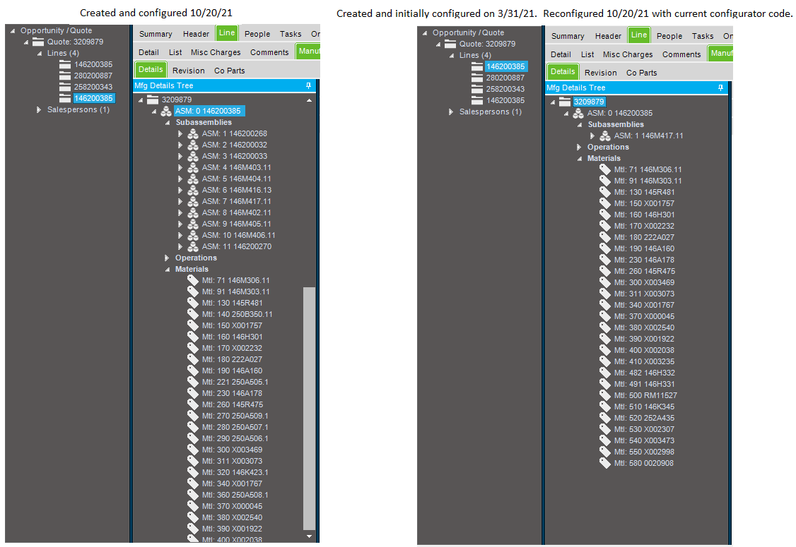

Here is a screen shot on the BOM difference between a new line I created today, and a previous line that I re-configured with the latest configurator code.
Any ideas as to why the BOM would be so different between the two?
Both appear to configure with the same speed so I think both are utilizing the same code.

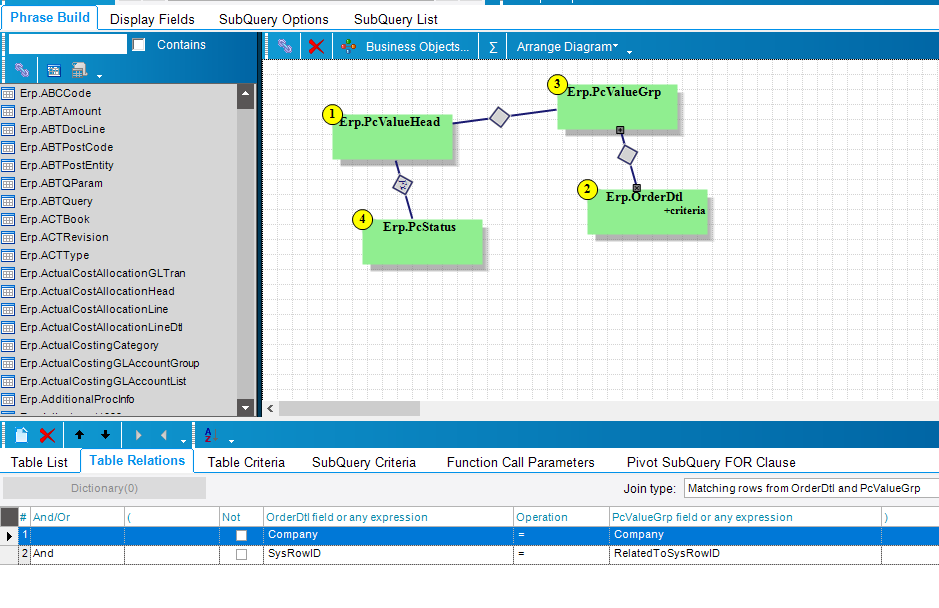

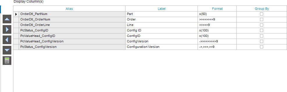

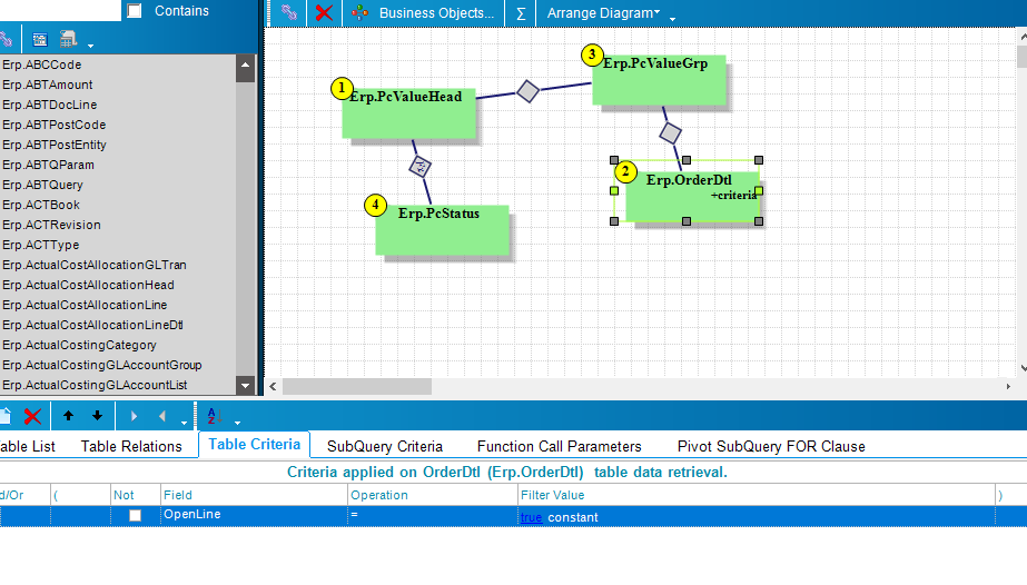

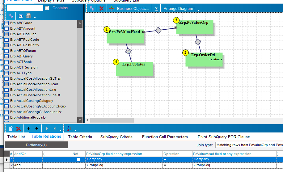

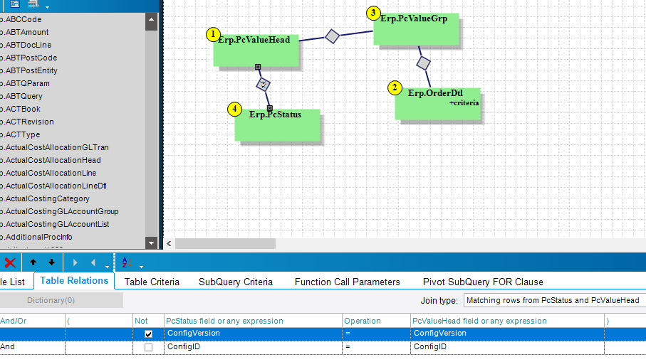

Ah, yes there is a cached old version that remains unless you run the verify existing configurations. That would update your changes, not update the part you still need to manually re-configure on the line level deleting any attached jobs that happen to exist to get the part to truly update. But it should give you the ability to actually take the changes if you re-configure the order line, may need to do something like change a field that triggers the new rules/parts/etc… I actually have a BAQ I got from on here someplace I don’t remember whom created it or what the topic was but this BAQ will display any configured part that is not on the same version. Version being created every time you change a configurator, in that if this is the cache issue you are running into it would show with that BAQ and then you’d know you’d need to run the verify program.
FYI for anyone coming to this later, did find the topic where I got that baq from. Worth reading to understand what the verify does and doesn’t do. Also to give credit to who created this baq to begin with.
