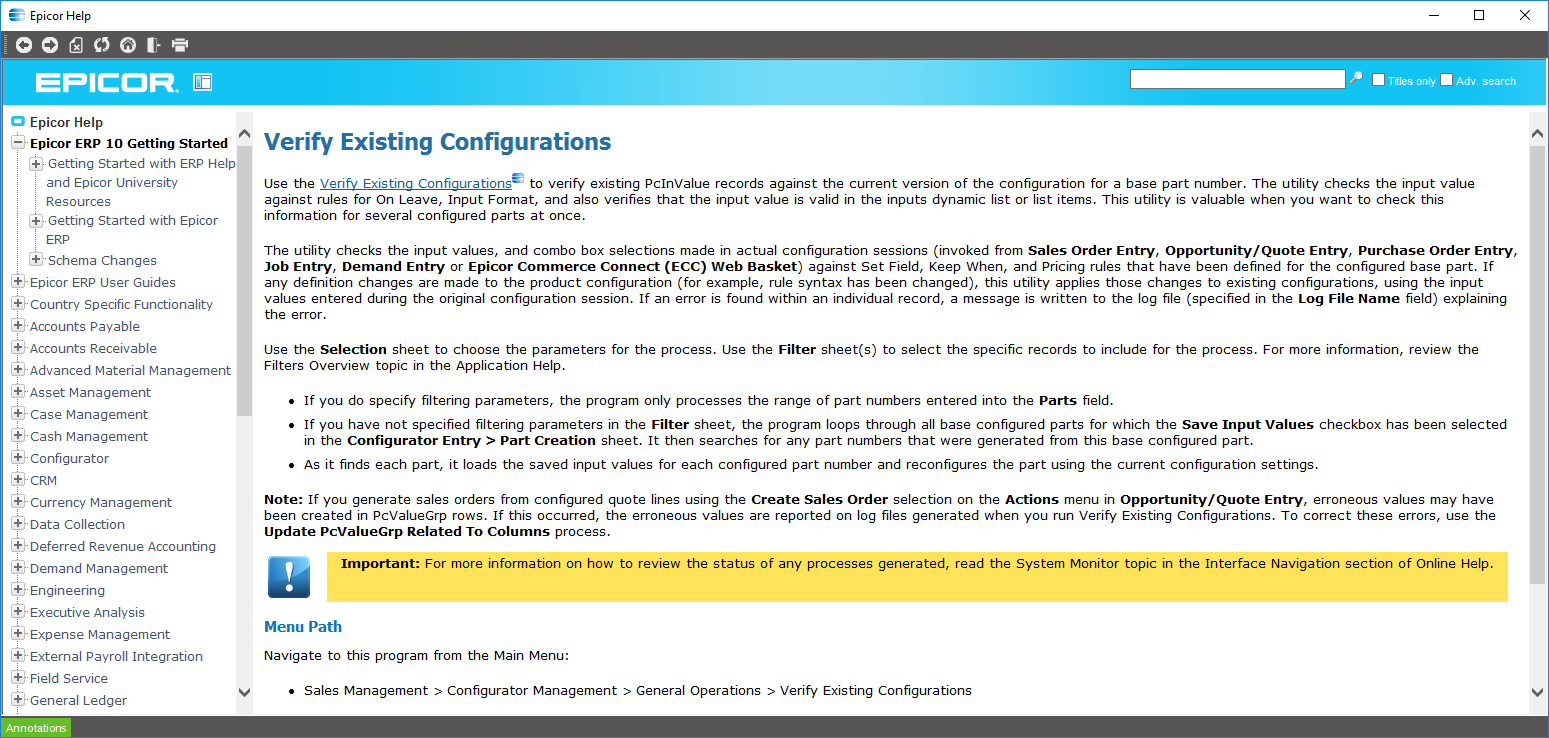

So the verify existing configurations repairs the configurations? Does it re-run the rules and stuff, or does it just restore the operations and methods that were created with the old version of the configurator?

I hope this E10 Help file image helps to better answer your questions…(if you double-click or right-click to view image you can see it better.)

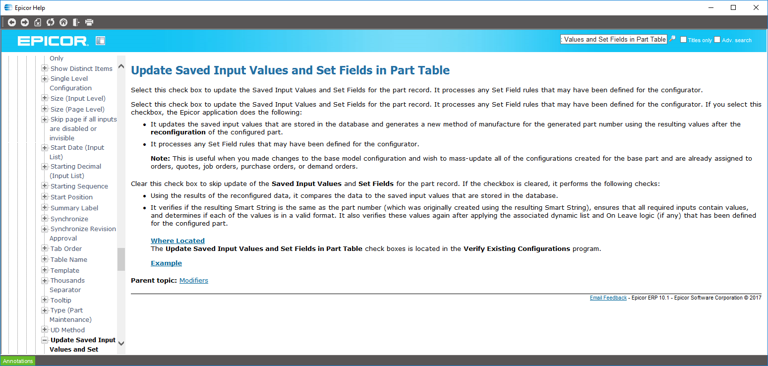

Excellent, thank you. I assume verifying alone isn’t enough to un-break the sales orders and jobs, you must also have the “Update Saved Input Values and Set Fields in Part Table” checked as well right?

All I can say is if you have a test environment then I would try the various options there to see what happens and if they give you the results you are looking for. And here is another E10 Help file on the Update Saved Input Values and Set Fields in Part Table option:

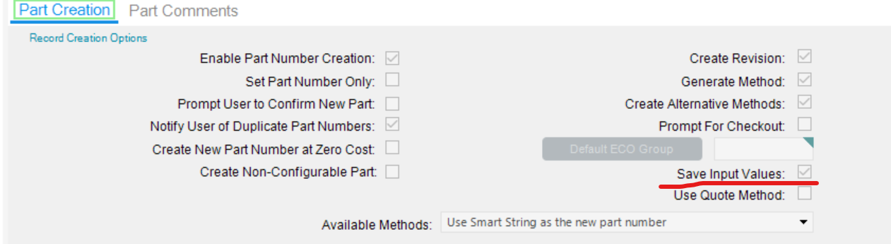

We only use smart strings as well - I was still able to get it to show outdated configurations, but it did not seem to automatically update them. I think “Save input values” needs to be checked for it to be able to update them, which requires creating actual parts, sadly.

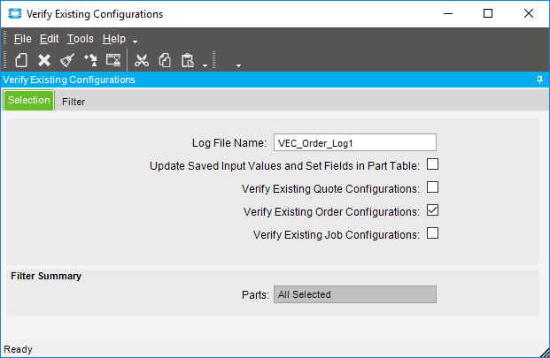

Hey, I tried running this process as we changed up our operation rules up quite a bit, but no luck. Tried it with and without “save input values”.
To confirm, does this process change up the method of the configured part? If I ever try to re-configure the part via another quote it does not overwrite the existing part in the system, rather picks up the old configured part and pushes it through exempting any rules…

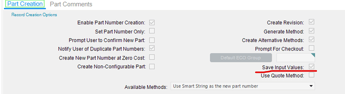

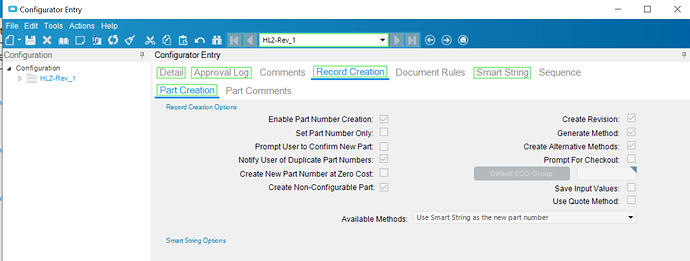

So I contacted Epicor support and they told me that the outgoing part (configured part) must be configurable and its inputs must be saved for Epicor to retain the connection.
If the part is already created as a non-configurable product and has transactions its locked in. I was advised to up-rev the top level part, copy rules and re-run it so the newer rev will create the missing link and thus be a reconfigurable product going forward (if your company uses only a limited amount of naming convention).
