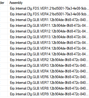

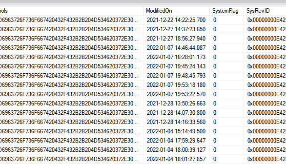

I was going to say check
SELECT * FROM Ice.Customization WHERE Type = 'ProductConfigurator';
SELECT * FROM Ice.CustomizationStore WHERE Folder = 'PC';
But it may be LINQ Issue as you said, notice how the SQL is in odd order.
I don’t know what this means, but some of the Target, Project, and Assembly columns in Ice.Customization mention VER1, VER3, or VER6. For example, one Target is MFGD_VER1__DomeSub. There are two rows for each of my configurators, with Targets formatted {company}_{version}__{configID} and {company}_{version}__{configID}A_.
