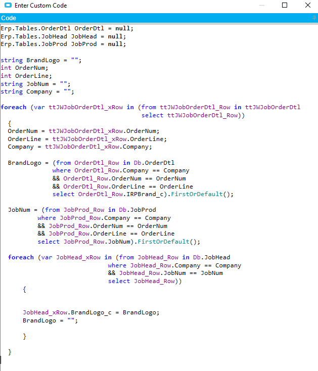

Here’s the code solution I came up with to accomplish my goal. Is there a better way to do this?

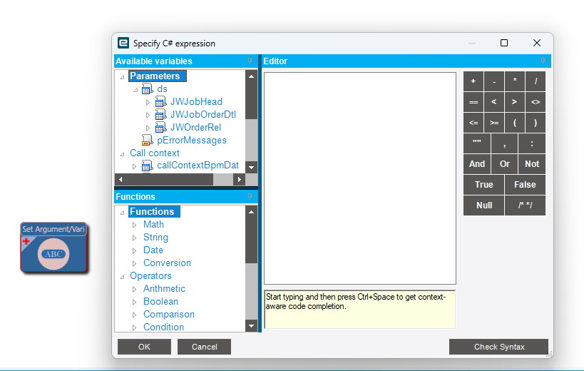

I would add a test variable to the BPM and then pull in the Set Argument/Variable widget to a look at the datasets that are available in the context. It could be that the dataset name has changed. Keep in mind, this screen shot is from 2023.2.

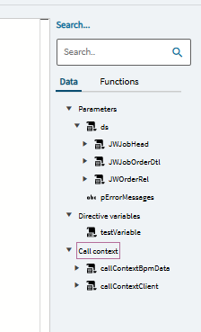

Here is what I see in Kinetic:
