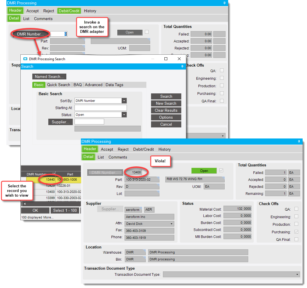

Data entry for the initial UD is only half of what needs to be offered in this solution. These records will also be searched for (by “Key1” value [which is being referred to as an “NMR ID”]) and edited by various others in the chain of custody over the course of several steps in our Quality inspection-to-disposition process. Essentially, I’m trying to simulate/mimic the standard Epicor behavior as depicted in the DMR example below (but this functionality exists for almost anything one intends to look up and retrieve as an editable record):
For example, I can look up a customer record and edit that record at any time. The solution I’m working on also needs to offer that functionality.

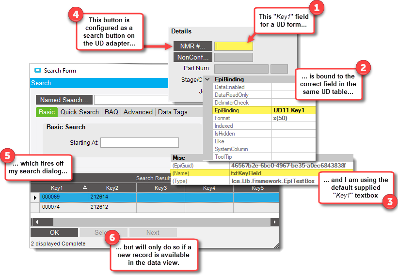

Here’s the basic setup on the pertinent controls for the UD form:
Notice that there are two search buttons on the “Details” section of the UD form.
“What other details might be affecting the behavior you expect?”
We’ll, the NonConf search works, I believe, because the workflow requires a new record to be requested from the UD UI. So, I’m getting a new record first (and an available data view) then, searching the NonConf adapter to pull back data to the UD adapter. However, with the “NMR ID” search on the UD table (again, “Key1”), I’m not supposed to be requesting a new record here. I merely want to search for an existing NMR record and pull it back for editing. So, no UD data view exists at that point.

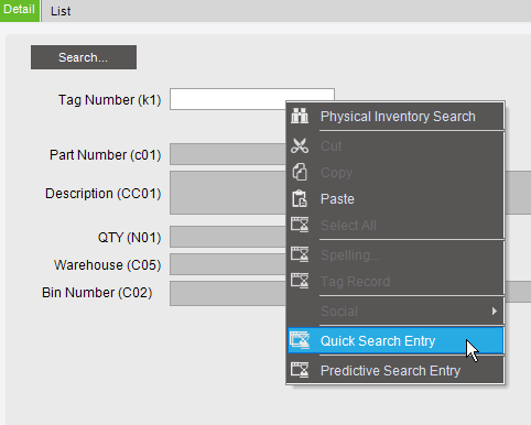

So I did basically what you are trying to do. On the Key1 box , right click, and go to quick search entry. Then you can make a new search based on a BAQ, and if you check the Suppress Base checkbox, that search will replace the stock one.
Here’s my UD10 search
