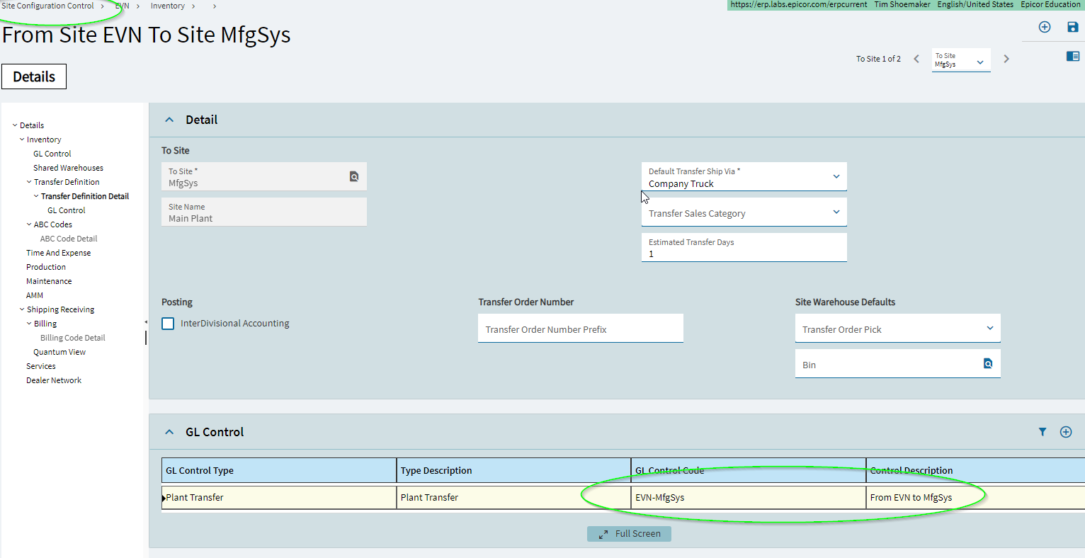

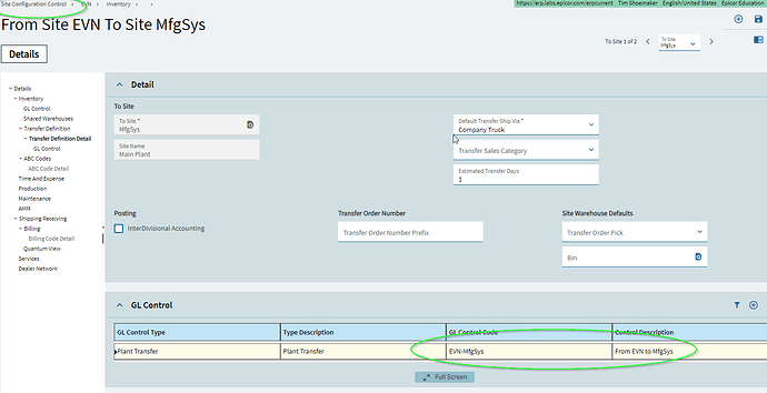

You need to create a new GL Control code for each plant transaction (plant 1 to plant 2, Plant 2 to plant 1) to specify the variance account: Note that the variance account applies to the “TO” account.
THEN in Site Config Maintenance, you need to apply the GL Control to the Sites

That was it Tim. We’ve been live for 3 months and first time we’ve hit this. Guess full credit to the team setting up the parts and we’ve been lucky we’ve not transferred any other faulty parts between the two sites. Now the capture runs we’re going to get through month end and then setup a new account to place any variance and proactively target all parts that could cause a future issue.
