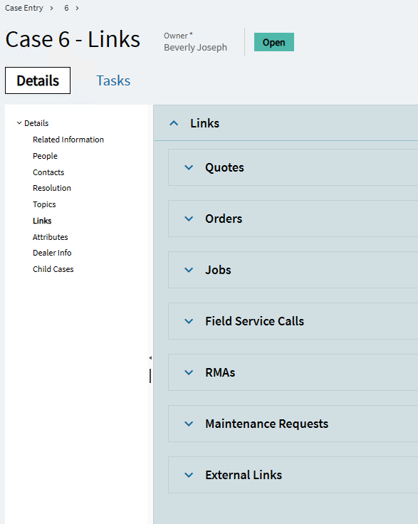

The Case Entry module is a lot closer to what a proper CA system looks like. If we didn’t have a pre-existing CA process (baked into a terrible Access DB) that they wanted ported over point-by-point, I’d probably have looked at Case Mgmt. I might look at it again when we ditch classic, though Case Mgmt is at its heart customer-focused.

Nor was I saying you were wrong. I hope it didn’t come across that way. I was merely trying to clarify my prior statement, and (for anyone who comes across this in the future) throwing it out there that, if you license it, Case Mgmt is a far better starting point for CA management than the actual CA module if one didn’t want to go fully custom.
And you’re completely right in that Case Management needs a VASTLY better press agent. Maybe even a listing on the DMR overflow menu to create a new Case…
And add DMR/CA to the Case Entry Screen. Both already have links to HDCase.
