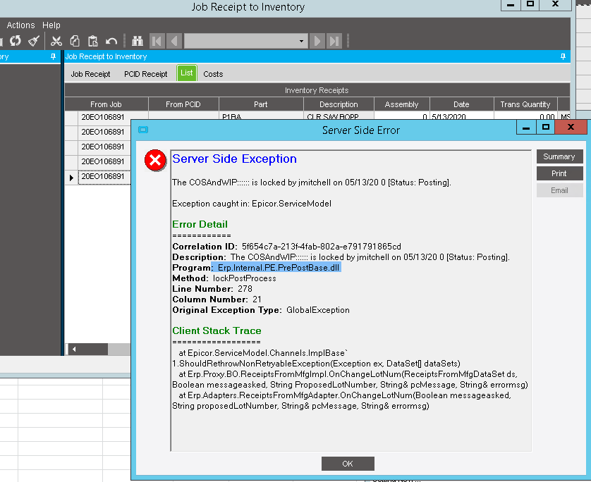

COSAndWIP:::::: is Locked Error during Job Receipt to Inventory
We discovered a bug in 10.2.5 and 10.2.600 versions where if you have two different sessions trying to receive jobs to inventory you get a server side error saying that the posting process is locked. I am able to replicate this by Paste-Inserting data into the Job Receipt screen with two different sessions at the same time.
Has anyone else experienced this and if so were you able to find a work around?
Did you ever fix it?
It has been fixed in 10.2.600.6.
