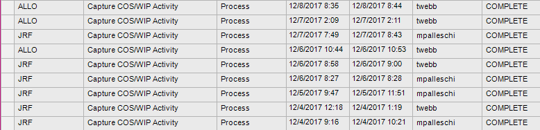

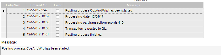

Hello,
In our Epicor 10.1.500.11 environment, when we run processes that use the COSandWIP posting process the task sometimes stalls out for no apparent reason. As you can see in the screenshots, the process sometimes takes a long time to complete. For the times it does take a while, there is always a gap between the posting process starting and it actually doing anything. Are there configuration items in the system we can look at? Is this a known issue in the 10.1.500.11 version of epicor? I am at a loss about why this could be happening.
I’m surprised no one has posted to this as one of our sites that were using 10.1.500 had the problem almost every week or so. Even with upgrading to 10.1.600.13 we are still facing the issue :frowning:

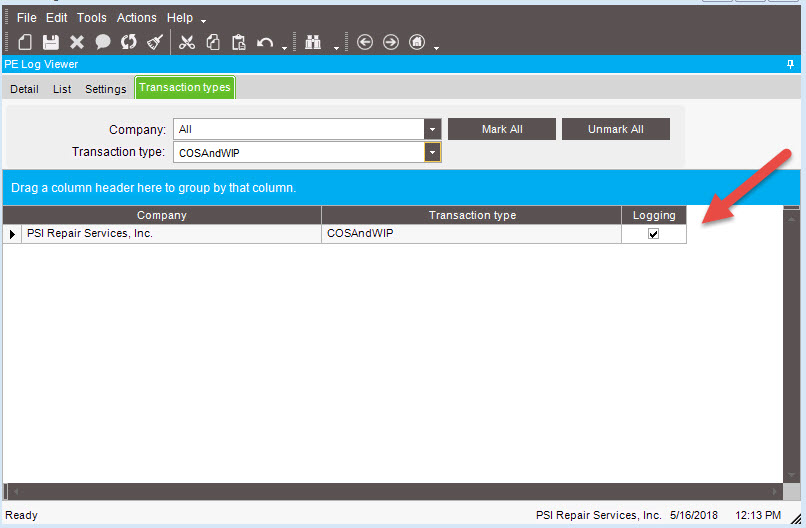

We are currently running Epicor 10.1.400.38 and have the same problem. Epicor Support advised that we disable the Posting Engine logging for the Transaction Type.
