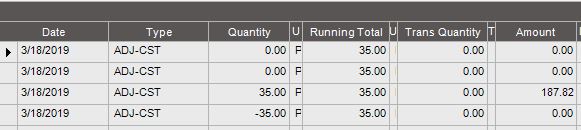

Is that a part in 2 different warehouses?

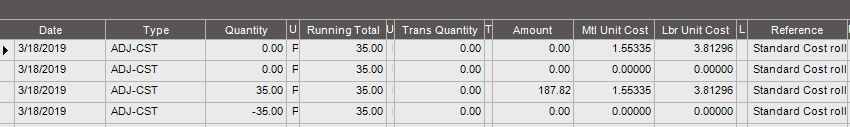

Are those four trans lines for one Cost Roll-up? And what does the Mtl Unit Cost column show?
And FTR - A part using AVG cost will only create an ADJ-CST when a manual cost adj or cost roll-up is done. A part using LAST cost will create ADJ-CST every time a receipt to inventory with a different cost, happens
Does not appear to be, no.
Correction: In Part Maint, Sites, Warehouses, List it shows two warehouses, one primary the other one is obviously secondary.
so for each warehouse, you get a pair of cost adjustments. So you get 4. You have none in the second warehouse, so it’s 0. I think you’re fine.
