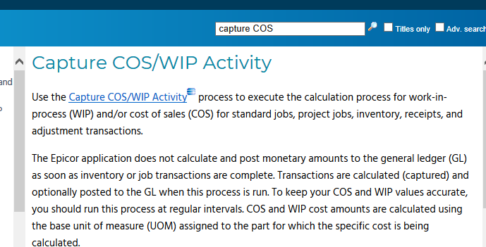

Is someone running COS/WIP capture? that’s the process that takes the operational transactions and translates them into the GL transactions. That needs to be run periodically. The transactions that happen until that is run, will not show up in the GL.

what did you try and search for? It’s all in there.

I was speaking of the Part Tran History running total. So I looked in the help files on the Part Trans History and it gave no info. Didn’t think it would be in this section. I will read it. Thanks.
I thought your were talking about the capture. I thought that’s what you couldn’t find.
