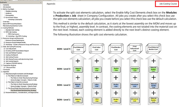

I have Job Cost tech ref guide however split cost elements concept is clear I didn’t find much on affects of Pull as assembly box checked while rolling up the costs. Logically, it seems like if Pull as Assembly this box is checked all the costs will gather into the parent level job but after roll up I didn’t find that to be true.
I am okay to take the Costing course or even getting the course guide if there are mentions of these modifiers in there. Do you know if they do. I looked up on Epicor learning but didn’t find in at least the keyword search.
