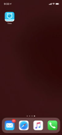

Epicor recently introduced the application “Epicor Time Management” for smart phones and it might work for companies on E10 that are willing to expose their data to the public internet (or already do, because they are cloud customers :slight_smile:). It works on my iPhone and I’ve attached screenshots of a company-internal demo. With this, employees only touch their own electronics–as several other responders also resolved using other methods.

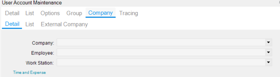

For Mobile Apps, you use User Account Security Maintenance to map Employees to Usernames. I haven’t tried mapping multiple employees to a single login though…
