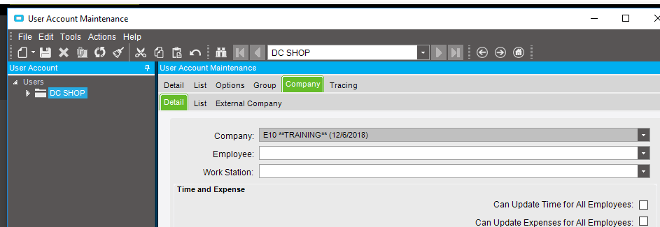

Hmm… something is wacky doo for sure. How are the user and employee records setup. I haven’t looked maybe on later versions they assign default license to folks with actual Epicor User records? I’m throwing s*it at the wall there.
I wonder IF the Username you use to login into MES, if it’s not tied to an Employee via User Maintenance, if it assumes a Default License.
Right i’m wondering if something on that lines is goofed too. @kp11 could you send a screenshot of employee maintenance for a person and if they have a user file record their user company record too. Redact whatever you need to.
If you are talking about this screen…I don’t think that is the issue. We have generic log ins not tied to employees and they are pulling a Data Collection license.

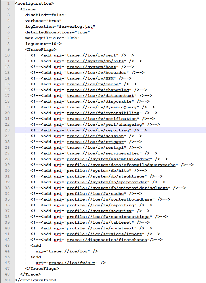

In app.Config try either the license or session trace and monitor how and why the licenses are consumed.
The license trace is in newer versions of E10 to reduce the noise in the logs. The older session trace will have the license info though
Agreed with @Bart_Elia
Basically If you go to to your AppServer UNC path (example: \SERVER\c$\inetpub\E10_Migrated102300\Server) you will find a AppServer.config file, you can enable additional logging. There are many more options than what the Admin Console can enable at this time.
Simply remove the
<!-- and -->
Press Save and it should start logging.
Then you should be able to see additional details in your ServerLog.txt file(s)

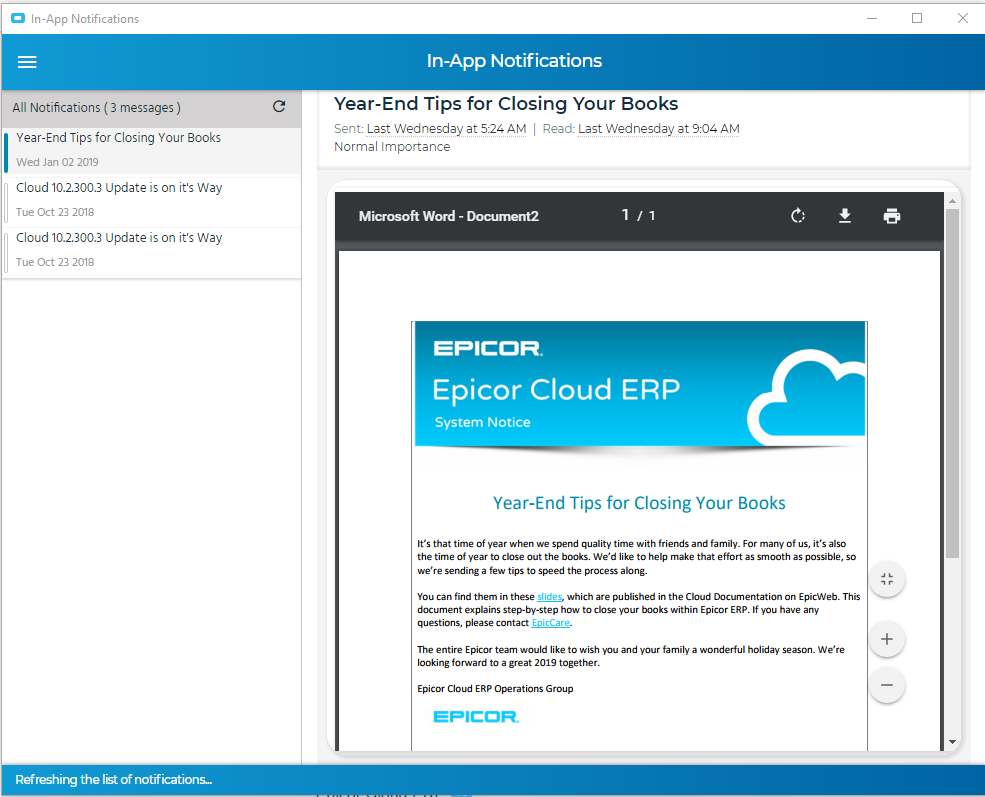

i wonder somehing - can you check to see if those users have a pending notifcation - I am wondering if this may be tied to the newish cloud ops notifications we now get. Are you on Premises or Cloud?
//edit: We are dedicated tenancy in cloud and now have Notifications in the system manager > actions > opn notifications . Pops up a window like this. Wondering if the window is rendered in a way it is changing the license assigned (even if these are just unread)
