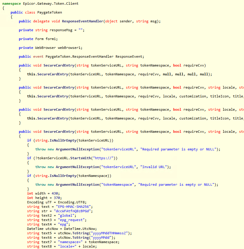

Well I can tell you that the hosted page is invoked from Erp.UI.Shared.dll, as I don’t work with CRE or the CC transactions in the ERP my technical knowledge is very slim.
Well, it seems I may have gotten lucky! Epicor hardcoded the request including authentication (without obfuscation!), so I may be able to reverse-engineer their POST request and show the hosted page after all!
Are you able to call the CRE Credit Card Entry as a Service, not Dialog Form?
Yes, I did manage to reverse-engineer the way Epicor Web Access calls the service. No documentation, the source code I decompiled is half broken (from factory!), and there’s a bunch of useless obfuscation to get through, but it does work. Here’s basically how you do it, with two small JS scripts:

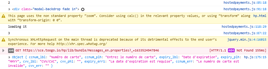

I get the same, but it works… Seems to be a bug with one of the resources on the service end… Do you still see the modal opening? This is what my console shows me when I invoke the openHostedTokenPage function:
The additionnal output at the bottom is because of the translations to French I pass to the service.

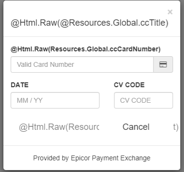

I have one more bug in the console
and the form is opened as below
What do you think?
No idea about the blocked autofocus, but you need to edit the code and not use it as is. In my script above, I use Razor to pass translations into the service. You need to change those or remove them from the call if all you want it English.
Also, make sure you change the SiteID in the script! Otherwise your tokens will not be accessible.
Can you send me the Razor page code?
I’m afraid not! lol It’s part of our application, and besides, you don’t need it. Just remove the @ directives from the script.
