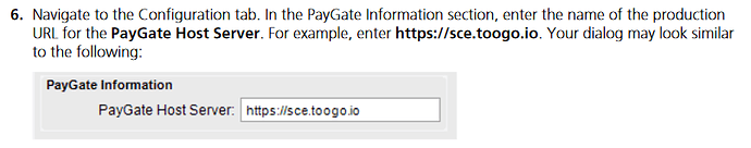

This paragraph in particular confuses me:
Is this the actual URL I am supposed to use here, or am I supposed to put in the PayFlow Pro gateway address? Is this an Epicor-owned server?
Also, how do I setup PayFlow Pro test mode, do I simply check the “Test Mode” checkbox, and this will use the test gateway?
If you are using the Epicor Gateway via CRE that address is correct. You will need to install the CRE agent on a server in your environment and point ERP to that agent. Default port is 9876.
