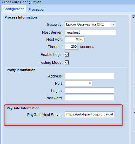

Hello,
I was wondering, if anyone has been using the “test mode” for PayPal in Credit Card Configuration before?. If so, could you shine some light on the screenshot below?
I have the PayGate Host server as the test site for PayPal?
Test Sand Box: https://pilot-payflowpro.paypal.com, is this correct?
I am looking to move to CRE and have never messed wit the credit cards. Was the PayGate what you said it was?

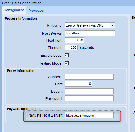

No, its this one
Thanks! I was curious. The guide showed that one but didn’t say it was the exact one. So I was a little confused. Glad you had asked! Sorry no one gave you an answer on here.

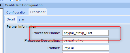

Are you using ‘Epicor Gateway via CRE’ and then on the Processor tab using the paypal Processor Name? I don’t have the option for ‘Pay flow Pro via SDM’ on the Gateway dropdown.
Is this what I need for Kinetic/public cloud?
