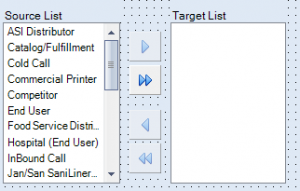

The left and right sided box thing what you’re looking for?

    /** The following is broken down into a few simple parts. It generates a string list delimited by whatever character you would like
    ** This is only one of many implementations of InitDataBind. A screenshot above shows all of them. This is the only one I know how to use.
    ** It was modeled after the attributes in Customer Entry
    ** @SourceDataView (string) - This is the dataview containing the values for your source (left) list
    ** @SourceValueMember (string) - Think of this in terms of the dropdown list Value Member
    ** @SourceDisplayMember (string) - Think of this in terms of the dropdown list Display Column
    ** @StringDelimiter (char) - This is the character that you would like to use to seperate your values. Epicor typically uses ~ but you may use whatever suits your need
    ** @TargetColumn (string) - The column binding to insert the delimited string into
    ** @TargetDataView (string) - The dataview that your column to insert the string into resides.
    ** @Trans (EpiTransaction) - duh....
    _atrpnl.InitDataBind("Attribut", "Attribut_AttrCode", "Attribut_AttrDescription", ',', "AttrList", "AttrList", oTrans);
