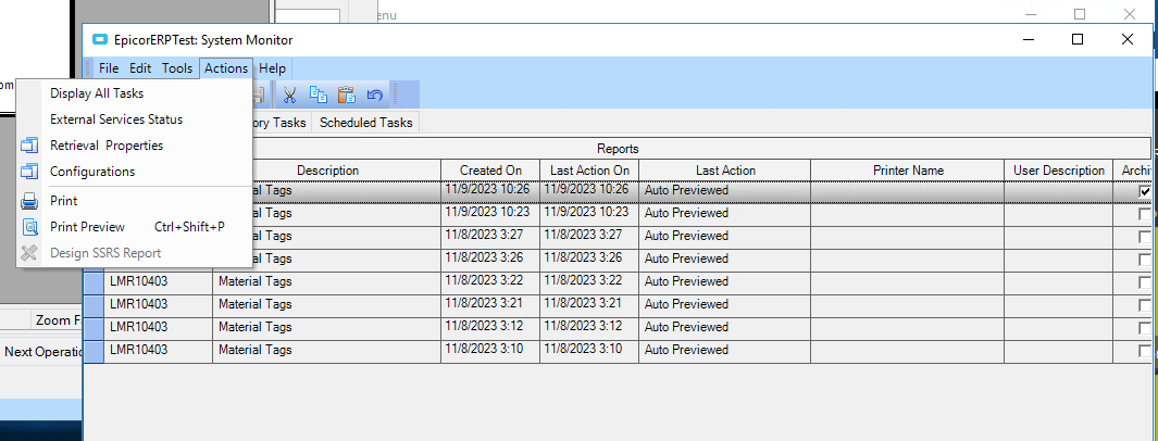

  1. Preview a Report and set the archive period for 1 day. Preview the report and then close the preview.
  2. Open the System monitor and select the row of the item you just previewed.
  3. Click on Actions → Download Crystal Reports Data - select a folder. Epicor will download two files one will be the XML data file and the other will be the Crystal Reports RPT file.
  4. Open Crystal Reports and open the downloaded RPT file.
  5. Change data Location to be the downloaded XML file.
  6. Modify report - Save.
  7. Create EpicCare ticket and attach the updated Crystal Reports file. Make sure to give epicor your server number and specify to copy to both Live and PIlot.
  8. Done.
I do not have the ability to see this. I am signed in as an admin. Am I doing something wrong?
