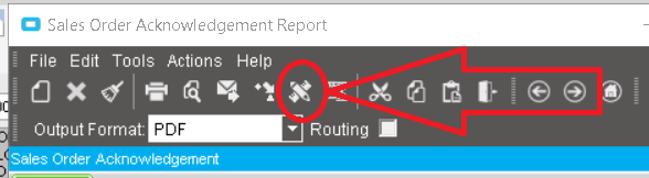

  1. From the print dialog - select the “Generate for Design” Button: image

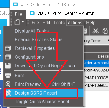

  2. Open the system monitor and select Action–>Design SSRS Report
  3. Click on Actions–>Download. Select the local path for your SSRS. Then click on Yes to open report for editing. .

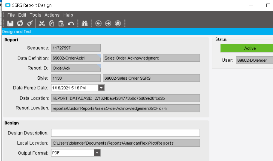

  4. Make changes and save - then from the SSRS Report Design dialog - click on Actions - Preview
  5. When you done making changes - from the SSRS Report Design dialog - click on Actions–>Publish (same as upload).
this is MUCH easier than uploading every time. The preview uses the same guid value.
