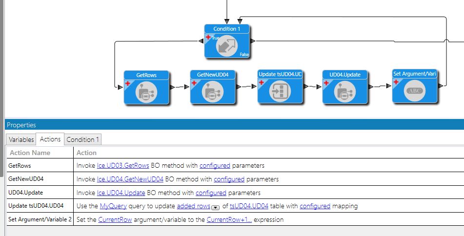

I am back at it again trying to copy a table. From UD03 to UD04. This is what I have so far. I am trying to use only the widgets to keep myself out of trouble, but I am not sure that is working.
I have a table full of data in UD03 and an empty table in UD04. When I run this custom action, I get this error:
Application Error
Exception caught in: System.Data
Error Detail
Message: This row has been removed from a table and does not have any data.  BeginEdit() will allow creation of new data in this row.
Program: System.Data.dll
Method: GetDefaultRecord
Can these widgets be used to copy all data from one table to another?
Initially I had set the where criteria for getrows to “”. But after some thinking I deceided to try to make a loop so I could address each row one by one. I start with a variable that equals the number of rows in UD03. I also start a varialbe for the current row =1.
Then I use a condition to loop through this segment, getting a row with criteria: “ttResultsRow.UD03_Key1 = CurrentRow.ToString()”.
The process executes, and continues holding up the entire epicor session until it finally fails in a server error. No rows copied.
I feel like this is closer, but still not quite right obviously.
A slightly more controlled test is giving me another error. I tried to set the where clause as mentioned above. Then I also limited the iterations within the condition to only the first 10 records. Now the error indicates that The table ttResults has more than one record. I believe it is in reference to the GetRows method. I am clearly missing something.
