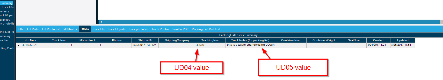

So I have a dashboard that is showing information from UD05 and UD04. UD05 is a comments table, and UD04 is for trucking information. I want to be able to let the users modify a comment (UD05) and be able to add tracking information (UD04). These are currently showing both values in one row in one grid. If I use the UD04/UD05 BO’s it only lets me change the fields in the respective table. Is there a way to call both BO’s? You can see a screen shot below of what I have so far.
On thought that I did have was to use context menu on the fields and create a update able dashboard for each situation so the user would right click, open with, modify x, depending on what they are clicking on. Does that sound like a valid option for making this work?

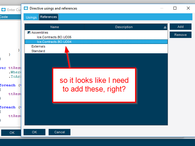

So I copied each of the blocks, I got some errors when I clicked ok, so I went into add reference assemblies (or whatever they are called) I added the ones shown below, and the errors went away. Does that seem to make sense?
Yes you’ll need those in order to use the BO’s

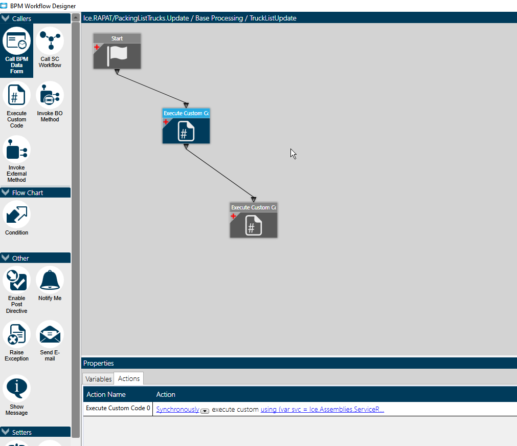

so I’m in the BAQ, and it looks like it worked for the first block (UD05) but the second block (ud04) doesn’t save. I switch the blocks around, and the table that saved switched with it. So it’s only working for the first block. I suspect the first BO sets the field of the other on back to the original value before the the second block can get to it. I need all of the code in one block to make this work don’t I?
If you copied all the code you showed me, part of it clears the RowMods which is not going to help you. Make sure you only copy the part of the code which does the Update to UDXX and not the other stuff
