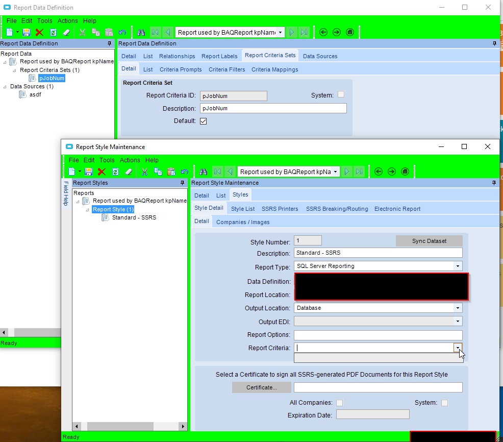

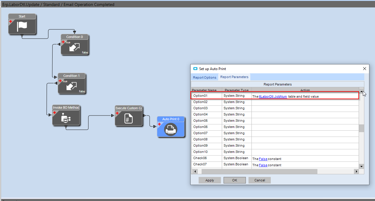

I’m having trouble using the GUI to code this and make it work. How can I pass a parameter to my SSRS report from my BPM? When I setup auto print, I cannot add any custom parameters, and it does not read parameters from the SSRS or Report Data Definition that I can see. I’m only trying to pass the job number so i can then filter that with my report.

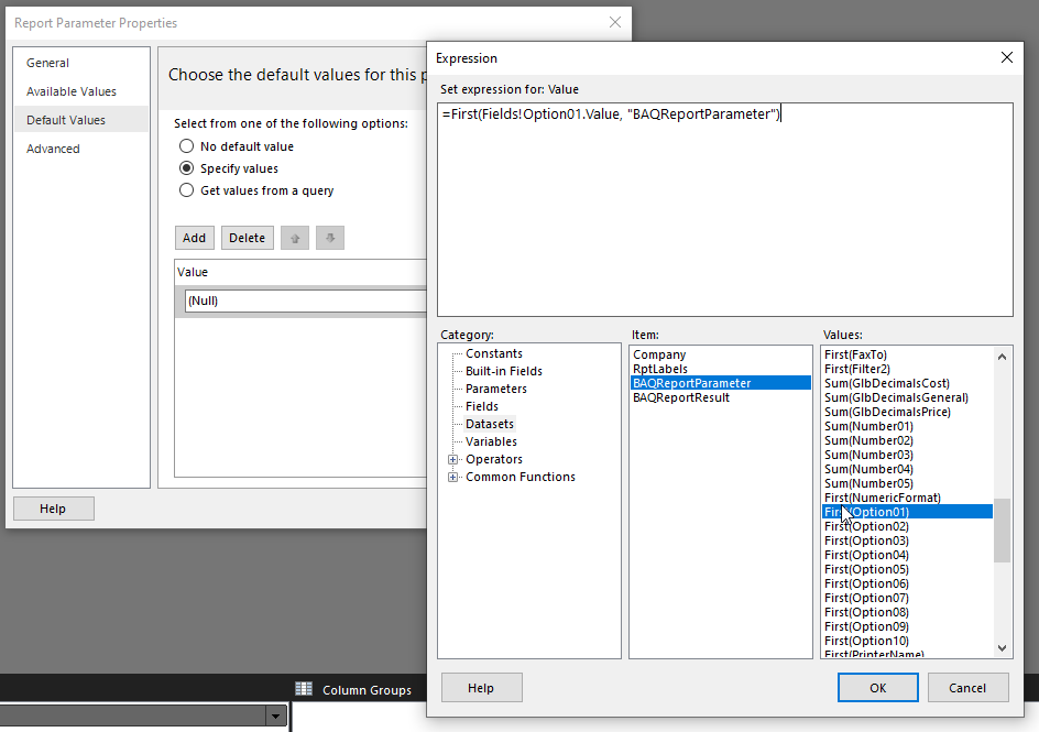

I didn’t get anything from using Option01 string.
I might have to execute custom code to get what I need, but i’d rather not have to figure that out for something simple.
I’m willing to use BAQ export process if I can call that from BPM and pass the JobNum parameter. That might be more efficient anyways.

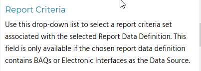

Could I use this criteria field? I dont know how to enter that data.
