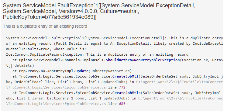

My problem is that as soon as this code hits a BPM it fails (error below) The BPM is simply a test right now with nothing more than a message box and the code fails before it even gets to that. So something in the code is not liking BPM’s. Is there something special that should be included in the code that lets it process thru BPM’s? The BPM I am using is on Jobentry.update Post-Process

jebo.Update(jeds);
