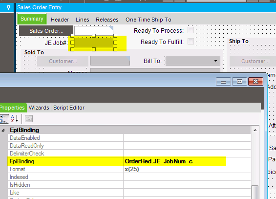

Open the customization in developer mode, select the field, and look at the field it is bound to.

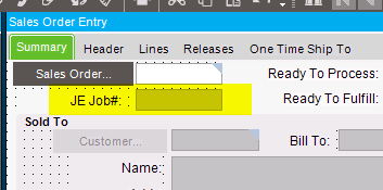

Example, here’s our Order Entry Screen with a field added to it.
After selecting the field, the properties show it is bound to
Yeah, I saw that area. My question is, in your example, JobNum_C, what populates that? I am asking because our is CSR_C and is a drop down box. But the drop down doesn’t have everyone’s name and has duplicates of several others. SO I am trying to find where it is at so can clean it up and get the others added to it.

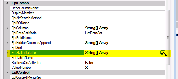

We have one that is limited to selecting X, P, M, or S. Since that won’t change or doesn’t need to depend on other tables, it is done as a Static List
clicking on the button there yields the list editor

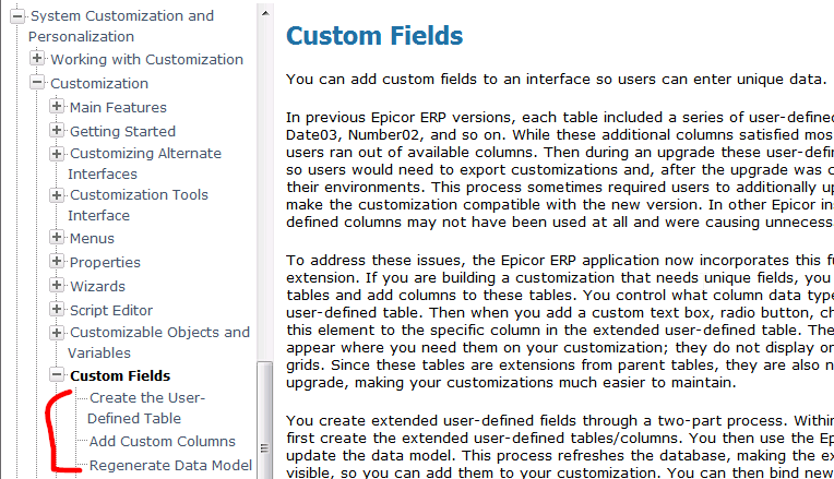

Lastly, how do you create a custom filed on the table?
The Online Help in E10 does a decent job explaining it.
the following entries describe it in good detail
