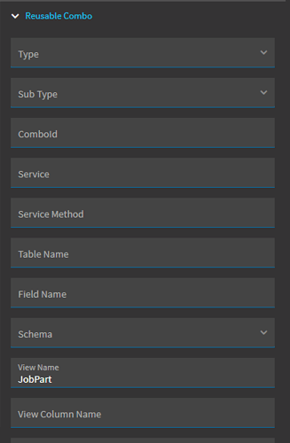

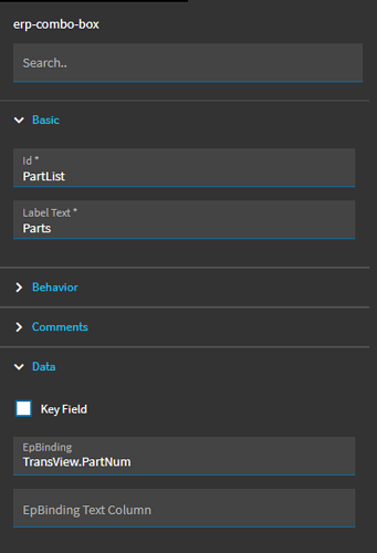

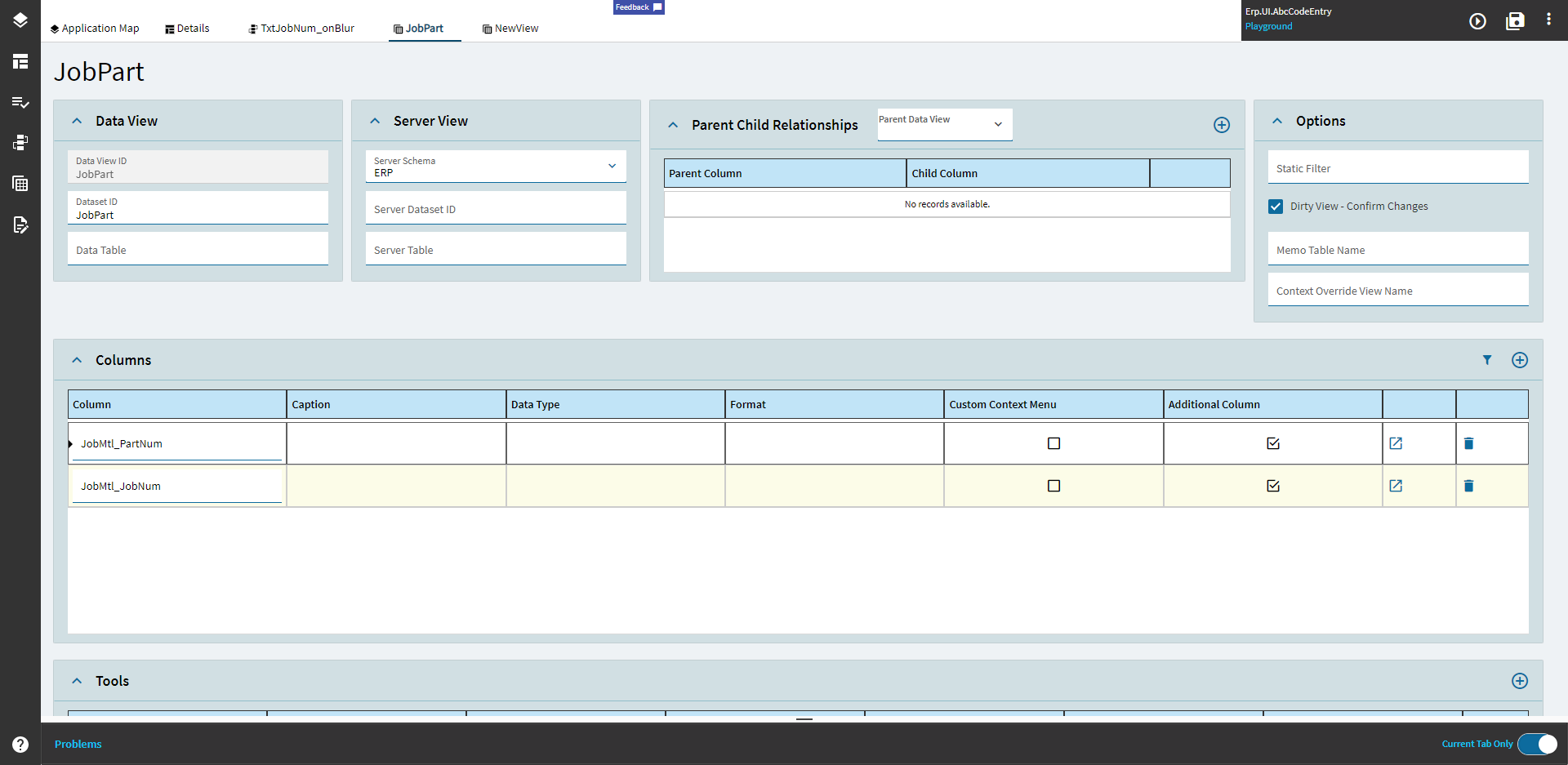

Try this out, instead:
Set up your view to receive the BAQ data:

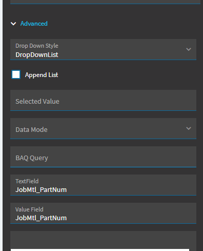

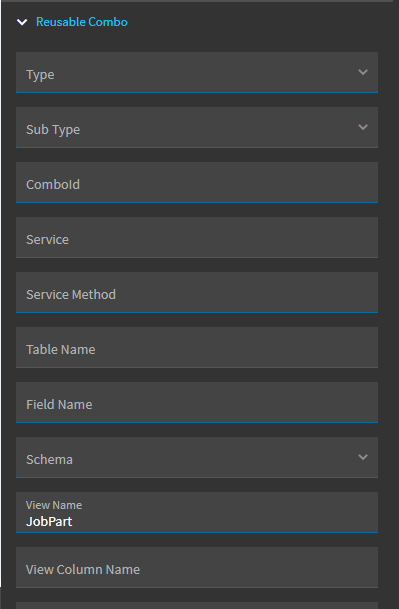

Set up your combo:

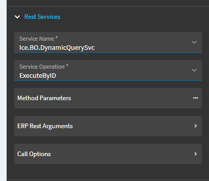

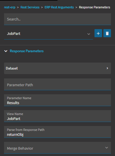

Create your event for the textbox OnBlur:
Fill out the erp-rest widget:

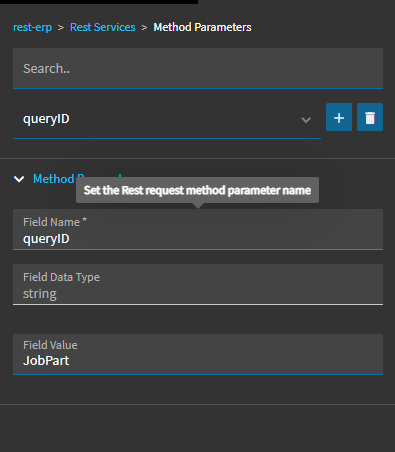

I keep getting “Query with ‘JobPart’ id is not found…” My setup is just like the screenshots you posted. Should queryID under MethodParmeters by set to my BAQ ID “PartsForJob”? I removed the parameter from my BAQ.
“JobPart” is the name of my actual query. Change yours to “PartsForJob”.
I changed my queryID as I suggested above and now the Parts combo returns all the parts, not just the one I want.
