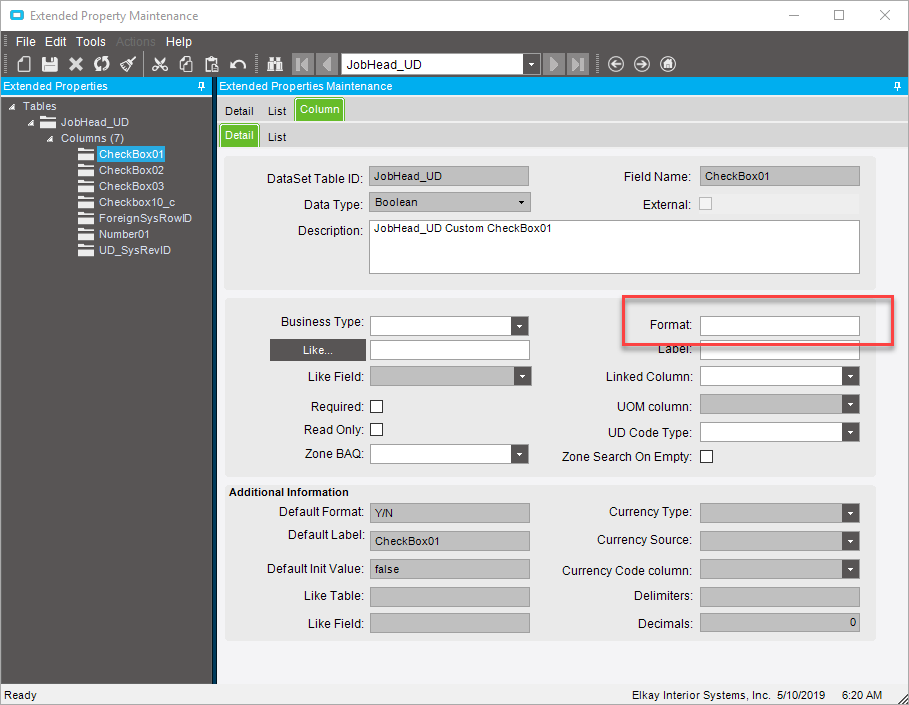

I have you guys tried to change the format in the extended properties?
Unfortunately, that does not work :frowning:

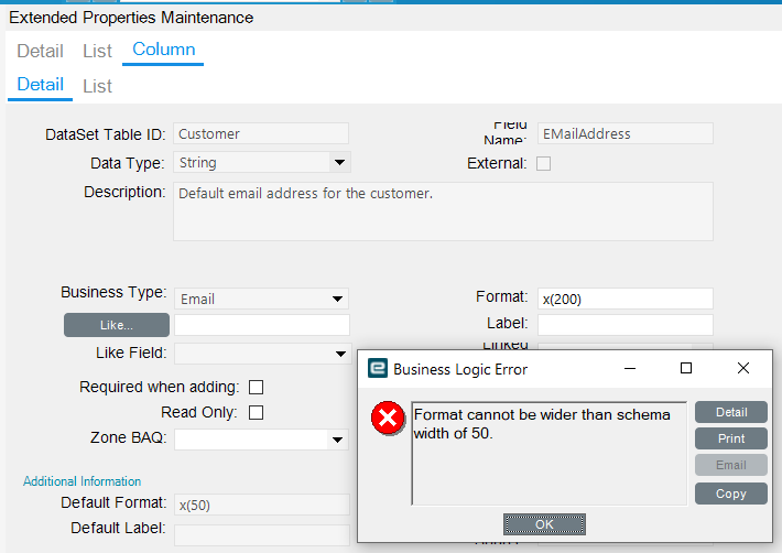

THe database field is 50 characters you can’t go beyond it without change the Database itself (which is Highly not recommended)
