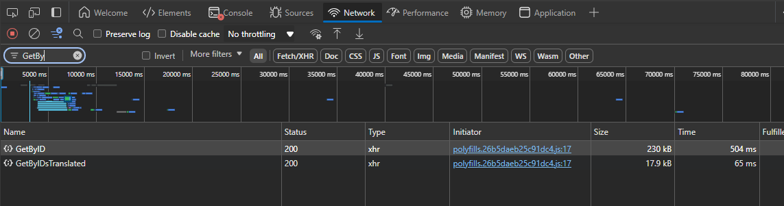

Specifically, check the Network tab for the GetByCustID call. Is it there? Is it red (error)? What’s the error say from the Response tab?

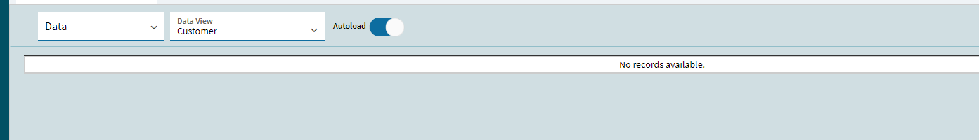

If that’s all fine, click into the Kinetic screen, then press CTRL + ALT + 8 to enable debugging, then CTRL + Alt + V to list the views. Expand your Customer view. Does it have data?
If so, leave debugging on and trigger your After_AfterGetByID event again. What does that say?
no errors in the dev tools however in the debugger…
customer shows no data…

Let’s focus on the GetByCustID call in the Network tab of Dev Tools.
Does the response have data or is it empty? If it’s empty, what does the payload show?
everything done from the browser, using Microsoft Edge, i do also have access to Chrome on my work laptop so can try through there?
dont have a GetByCustID? could this be my gremlin!

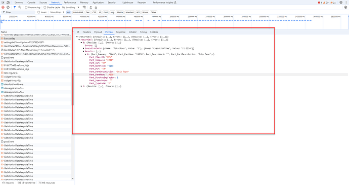

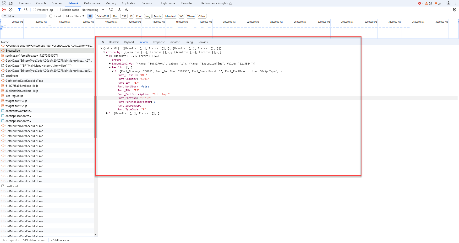

Click the event to open up the details. It should look similar to this:
It’s also concerning the service you specified is not being called.
Go to the Console tab, make sure debugging is enabled by clicking in the Kinetic window and pressing CTRL+ALT+8 (you should see a message in the console) and then enter a new ID to trigger the event you hooked into.
ok i see what the CTRL + ALT + 8 does i saw the message which stated debugging changed to true!!

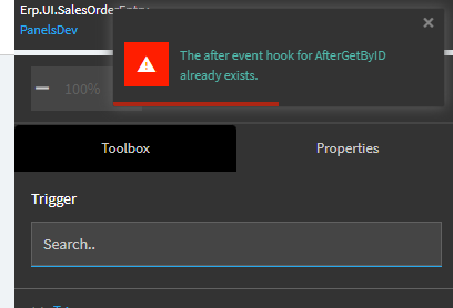

the execute BAQ is for a ‘stacks exist’ customisation we also have on the order entry screen, not a single one of the calls in the list are to either ‘Load_Customer’ or GetByCustID so it looks like my ‘fudged’ call does not execute at all - tbh when trying to select the aftergetbyid in the events section, i get an error saying it already exists, BUT its locked so i cant do anything with it.
Oh, you know what? I don’t think the “AfterGetByID” actually gets called. It’s a remnant from an older version.
Look for one called “Execute_GetByID” or something and change your event to be “after” that.
The best way to find the actual call is when Dev Tools is open and debugging is enabled, enter an ID in the form and tab (or whatever makes it go) and look at each of the events happen in the console.
