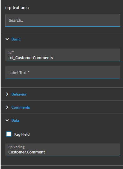

  1. Added a text area to the order head panel card

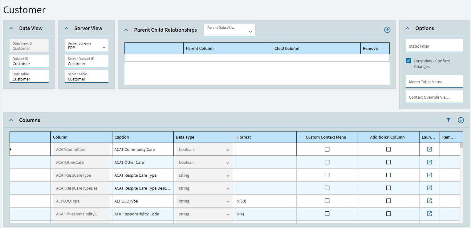

  2. created a dataview for the ‘Customer’
  3. set the EpBinding to the text area using Customer.Comment

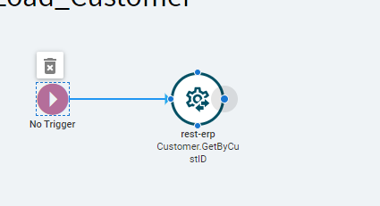

  1. Create an Event called ‘Load_Customer’
  2. Added a rest-erp service from the toolbox
Under the 'rest services of this service i have set the following:
  1. Service Name = Erp.Bo.CustomerSvc
  2. Service Operation = GetByCustID
Method Parameters:
  1. Field Name = custID
  2. Field Value = {OrderHed.CustomerCustID}
Response Parameters:
  1. Parameter Name = Customer
  2. ViewName = Customer
  3. Parse from Response Path = returnObj

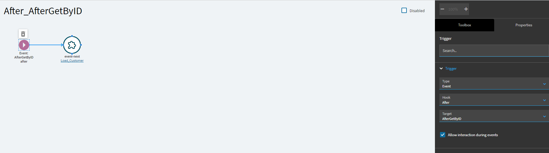

forgot to add i then have a second Event becasue the AfterGetByID is locked (the fudged part)
trigger is set to GetAfterByID (get an error and box goes blank but move away from the tab and back again and the method is there)
added an event-next after the trigger which then triggers the Load_Customer event.
after all this no comments are returned…can you please help
