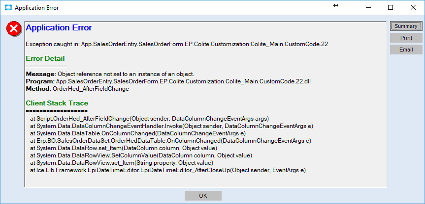

I get this error…
Is the proper way to go about this? It would be easier if we could use the basic C# connection code…

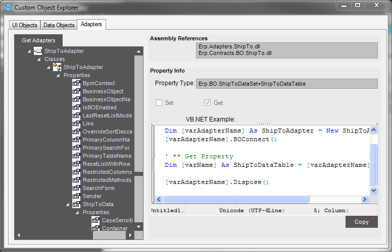

You can use the object explorer>Get Adapters to view the adapter properties and methods:

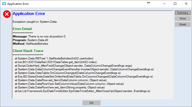

Speaking of the UD01 table… everything for the Ship-To table works great, but when the code gets to the UD01 portion I get the error…

The error is triggered at the MessageBox, and it doesn’t matter which version I use, I get the same error.
//MessageBox.Show(adapterUD01.UD01Data.Tables[“UD01”].Rows[0][“Number01”].ToString());
MessageBox.Show(adapterUD01.UD01Data.UD01[0][“Number01”].ToString());
Any ideas?
I think the UD tables have 5 keys, so you would need to pass in all 5 keys if you want to return a record:
bool resultUD = adapterUD01.GetByID(sStateAbb, “”,“”,“”,“”);
assuming your sStateAbb is Key1
Wrong, sorry, I was thinking of UD100.
Your error states that there is no row at position 0, have you checked that there is definitely data for that record in SQL though?
You were right about the 5 keys… I changed my call per your example and it worked! Thanks for the help!

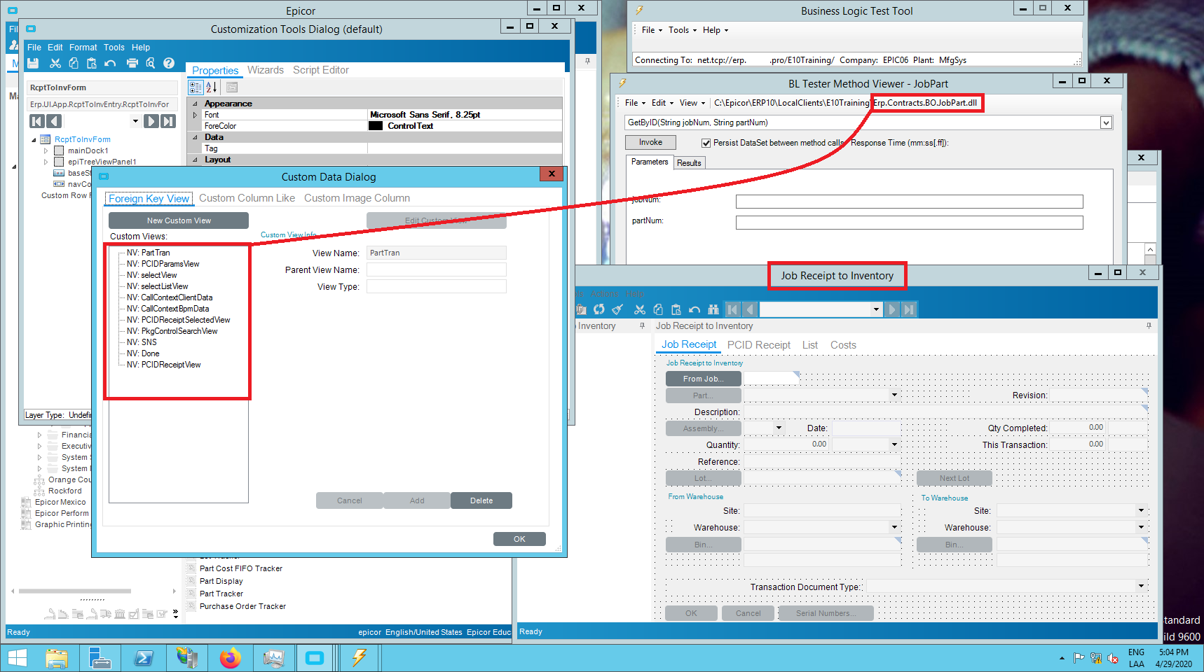

What would be the correct way to add a BO that is not directly related to custom views? For example, (see screenshot), if I want to add any JobPart field to “Job Receipt to Invetory”, I suppose I should use an intermediate table, but I don’t know how to do it, will you have an example of how to do this “join” that you can share with me?
Thank you
