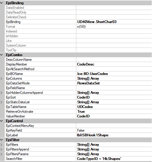

Is the combo you are filtering from bound? If so why not use the epifilters to automatically filter based on a other field?
Wait, you can use EpiBindings from another control in the filters?
Sure thing
Se the EpiFilters property and or EpiFiltersParams
EpiFilters
PartNum = ‘?{PartNumColName}’
EpiFiltersParams
PartNumColName=?[PartNum]
Ok, I must be doing something wrong…

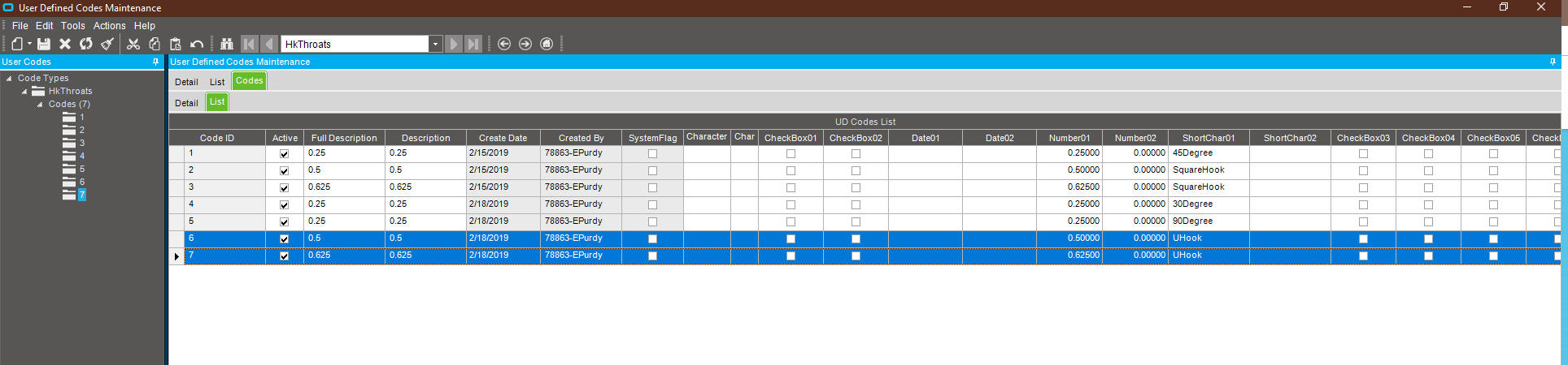

Combo1: Bound to UD40View.ShortChar03 and choices are from UD Code
Combo2: Bound to UD40View.ShortChar05, choices are from UD code, except filters so that UDCode.ShortChar01 = UD40View.ShortChar03
Combo1:
Combo2:

Attached is a simple customization for UD20, with just two drop downs and no custom code. The Epifilters give me an error, but support doesn’t get the error. They do agree the filter does not work though.
I also attached the UDcodes in excel format, so you can add those to Epicor with the “Paste Insert” function.
