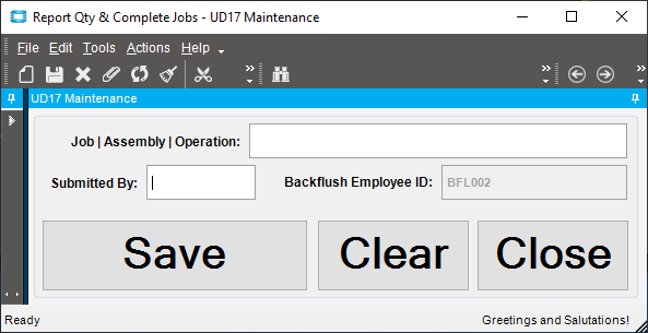

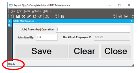

Complete Newbie here on Customizing a UD Form but just curious, is there a way to program the “Ready” message at the bottom of a form to say something like Successfully Processed: Job.Assembly.Operation (as shown below). Can anyone give me some idea of how this can be accomplished? I wanted to give some indication of the last record that was processed instead of presenting a pop-up window that the user would have to respond to (Click OK) every time.
Thank you for any help anyone can give me on this!
-Heather

@Chris_Conn, thank you so much for sharing that great post by @hkeric.wci and your thoughts! It was especially fun to play around with the Marquee settings! I love that and will have to incorporate that in other places!

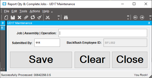

Like I said I’m a newbie to form customization (if you saw my code, you’d probably gag) but I did a combination of the PushStatusText and @hkeric.wci’s code and it seems to be working the way I need it:

@ERPSysAdmin obviously if you want to change the Text in any other portion of your code then you use
// Assuming you stored ultraStatusBar1 is global
// Check if Panel Exists ultraStatusBar1.Panels.Exists("MyPanelID");
this.ultraStatusBar1.Panels["MyPanelID"].Text = "Updating Text.....";
// Or use
((Infragistics.Win.UltraWinStatusBar.UltraStatusBar)oTrans.StatusPanel.UltraStatusBar).Panels["ID"].Text = "Hello";

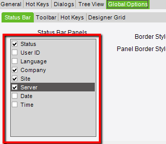

Thank you @hkeric.wci! I was struggling to figure out how to grab the panel later on and change the text. That’s awesome and very helpful! I did make my ultraStatusBar1 global and (I’m not able to see my code right now) but I think I’m using something like …Panels[1]… to pull from the array. But I like your suggestion even better because I noticed that the element number changes for some users who have say the date displayed at the bottom of their MES windows. Excited to try this! Thank you very much!!!
