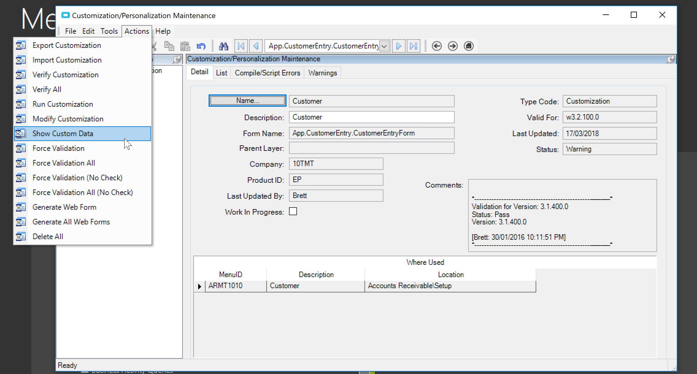

You can also fix this error with the customisation maintenance screen.
load the customisation into the screen, then click actions -> Show Custom Data.
Select the offending control and press delete key (on keyboard).
Click yes to delete control.
Click save data.
you should be good now.
You can actually change your name here as well if both controls are needed.
Thank you Brett.
This was a life saver.
