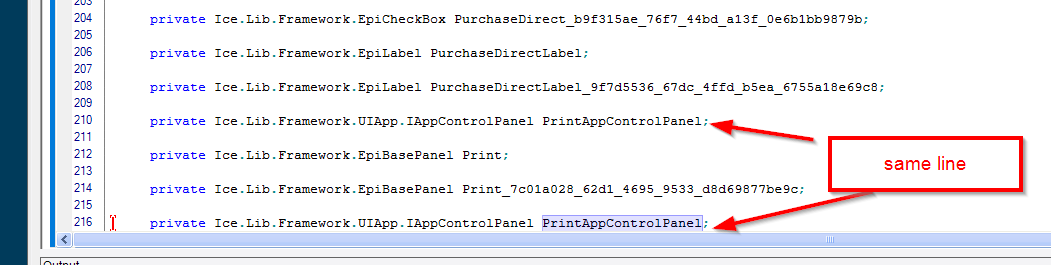

So I’m working on trying to replace a run-time dashboard panel in engineering workbench with an assembly dashboard. While trying the trial and error stuff that I have to do to figure it out, an error shows up. Sure enough I can find the duplicated line, (I’m sure from me adding and removing sheets). The problem is, it’s in the read only section of the code. It won’t let me edit it. Is there any way to fix this, or force E-10 to fix it? There is nothing in the sheet editor to delete anymore. Worst case I re-import the customization from production (thank God I’m in test), but I was hoping that there was a better solution.
Error: CS0102 - line 216 (216) - The type 'Script' already contains a definition for 'PrintAppControlPanel'

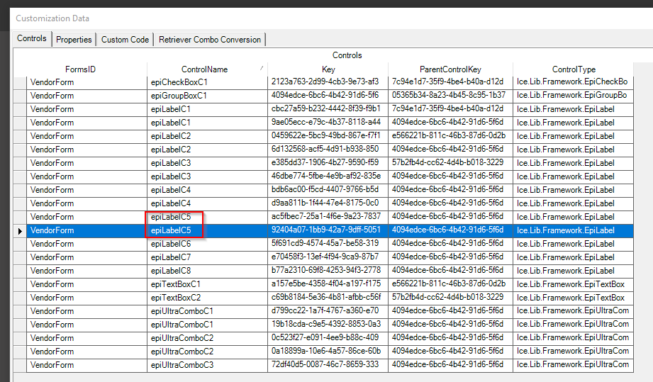

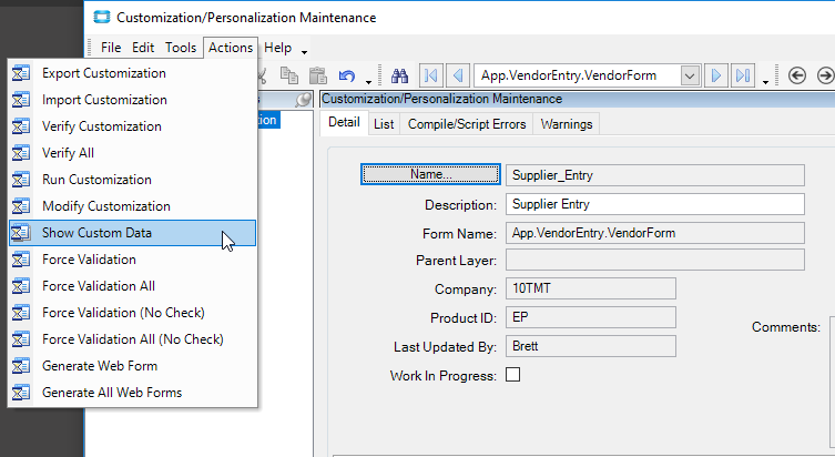

You can delete controls from the customization via Customization Maintenance. From System Management -> Upgrade/Mass Regeneration -> Customization Maintenance. Open the offending customization, then from the actions menu select show custom data. Note: you must be in the same company that the customization is from else the delete will not work.
Select the duplicate control.

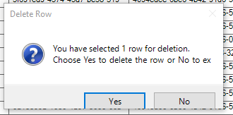

Press delete key (on keyboard) and click yes to confirm deletion.
Click Save Data.
Duplicated control should now be gone!

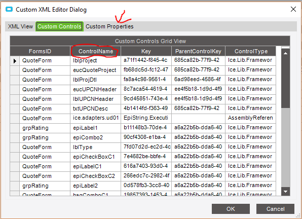

When in Customization, open up the Custom XML Editor…
Go into the Custom Controls tab and find the offending Control Name and delete the row. Do the same under the Custom Properties tab (there will be multiple lines here).
Make sure to MANUALLY save before getting out, you do not get a prompt to save.
