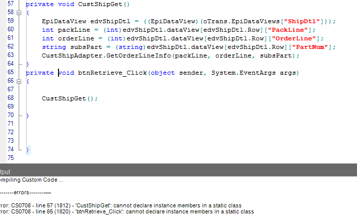

Alright so I added orderLine and subsPart (still don’t know what this is, so i’ll just do PartNum for it) -
but I got this error:
As far as Google goes, the error means that the method GetOrderLineInfo isn’t static and it needs a non-static reference to it? edit: even though it’s under “private static void…”
Where is your reference to the CustShipAdapter?

I’m not sure if this is correct - but I added a Part search button on a dashboard before so I copied the overall syntax of that.
Here’s what I’m getting:
If I add static:
Am I doing this wrong?
:slight_smile: Yes, but your spirit is in the right place!
What you did doesn’t solve the problem, but it is a nice way to clean up the code and make it more readable.
I am not sure what adapter exists in the native form, but if you wanted to reference the actual CustShipAdapter, you would first need to use the Customization Wizard to add the correct assemblies associated with the CustShipAdapter.
Comment out the bad line of code before doing any of this.
After that is added, you will want to makes sure you have added the statement at the top of your code (if it doesn’t exist)
using Erp.Adapters;
After that, I usually compile to make sure I can save, then I save and get out and back in.
In your CustGetShip method, you will want to create an adapter.
CustShipAdapter adapterCustShip = new CustShipAdapter(oTrans);
adapterCustShip.BOConnect();
//call your GetOrderLineInfo method here and return something, like a dataset.
adapterCustShip.Dispose();
Always make sure to release the adapter with the Dispose method when you’re done with the call.
Does that make sense? There should be a ton of examples on this site of using adapters.
