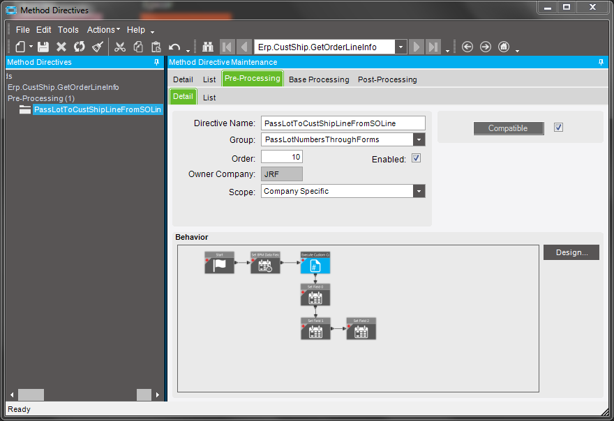

what @Randy said should work. I have a pre-processing BPM on that method to set some fields, so I can definitely show that example if needed.
I’ll give @Randy’s post a shot, but could you post that example? More information never hurts :slight_smile:
Mine is a pre-processing BPM built on that method. Pre-processing means that it gets assessed before the method fires. Post processing means it gets assessed after the method fires. Certain values will be changed/available in the pre-processing vs the post-processing. You won’t want to create any base processing directives…
Click the design button to go into the workflow designer.
In the example below, I am demonstrating the use of the Set Field node to a specific expression
In your example, you will want to have a condition node off of the start node that checks the value of the ttShipDtl.PartNum field.
My wildcard may be incorrect, but this is just an example.
If the statement evaluated is true, do grab the “true” line from the node and connect it with a Set Field node which sets the fields like I did above.

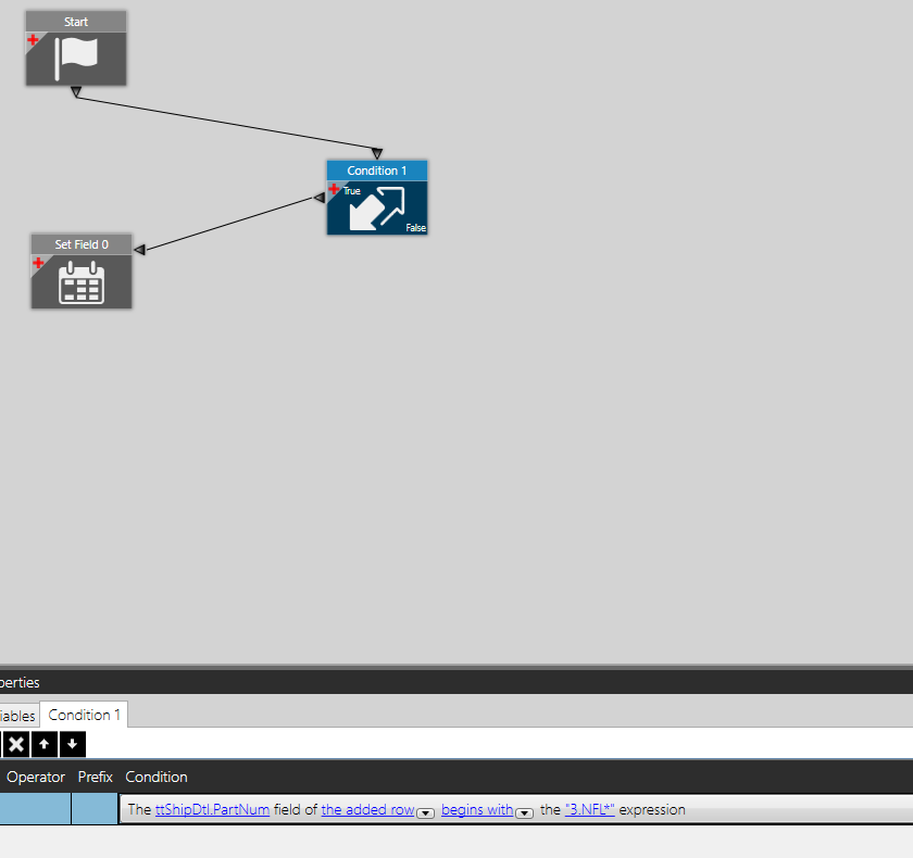

I tried both wildcards for the part (* and %), neither worked, then I tried messing with the “the changed row” and tried a few of those and none of those worked… I’m not sure if I need to use a different method or not - looking at the trace log file it looks like PartNum data isn’t called up when GetOrderLineInfo is processed, but the next one, GetOrderRelInfo does have PartNum data. So maybe I just need to change which method I’m adding the BPM to.
Here’s a pic:

AAH found the issue - I don’t think you can have wildcards in the condition process. Once I got rid of the * and/or % it worked!

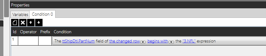

My condition-

This is on Pre-Processing of CustShip.GetOrderRelInfo correct?
Can you change your set field action to “all rows” instead of changed row?
That is correct. I tried it on both pre and post processing.
I changed both condition and set field to “all rows” instead of changed row and that didn’t work. I also tried just the set field to “all rows” but that didn’t work either.
