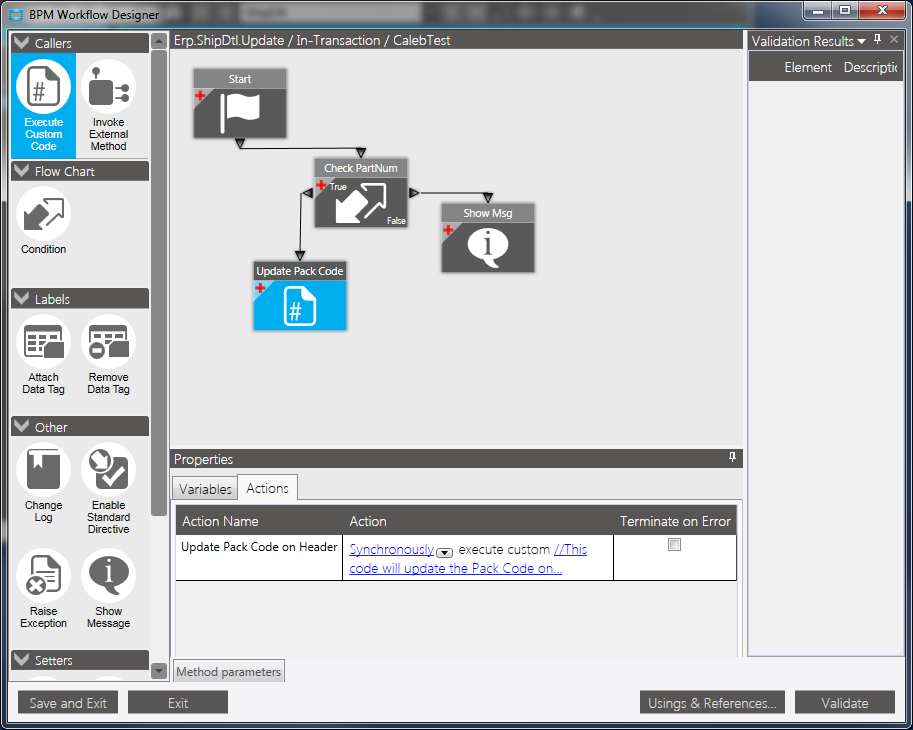

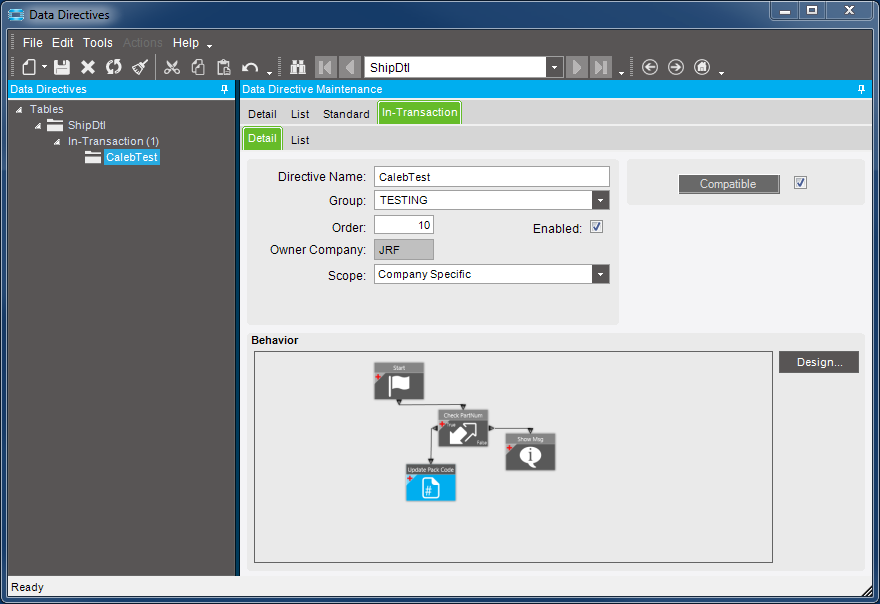

I created an In-Transaction Data Directive BPM on ShipDtl. Remember, data directives monitor table actions (read: updates, deletes, additions) and the “in-transaction” flavor means it get assessed before the action happens to the table.
The name is up to you as is the group, but keep in mind the scope. If you have multiple companies, you will want to be aware that this specificity will potentially affect other companies in this environment. Click the Design button to go into design mode.

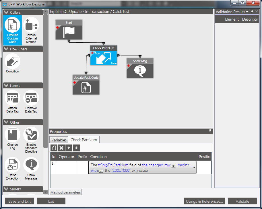

My condition checks the value of the part num on the ttShipDtl record. “tt” stands for temp table, and is used throughout Epicor to store temporary data for transaction use. I don’t believe it’s the same thing as a SQL temp table.
In this example, I’ve also routed a “Show Message” node off of the False path of the conditional node to tell the user (me) that the condition was not met. I’d obviously remove this before going into production.
In my custom code block coming off of the True path from the conditional node, notice first that I have selected “Synchronously”. This is the default, but the other option is to run the code asynchronously. That means it will fire when the application pool decides it’s a good time to fire, but I don’t want that in this case.
Below is my code. I’ve commented the hell out of it in hopes that I could minimize the amount of text I would need to explain.

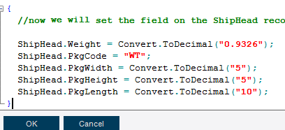

How can I set some ShipDtl fields? I figured I could set up another reference for it and put it under "Erp.Tables.ShipHead ShipHead; " like "Erp.Tables.ShipDtl ShipDtl; "
Then I try setting the WareHouseCode and BinNum fields but it continues to give me the compilation error
"Error CS1061: 'Erp.Tables.ShipDtl' does not contain a definition for 'WareHouseCode' and no extension method 'WareHouseCode' accepting a first argument of type 'Erp.Tables.ShipDtl' could be found (are you missing a using directive or an assembly reference?) "
It looks like ShipDtl doesn’t have a definition for WareHouseCode which doesn’t make sense to me…
EDIT - I think I found it out. Nevermind this post
Check the spelling of that field, it might be something like whsecode
I checked in BAQ and it says it’s WareHouseCode… I’m actually getting a little irritated with this. I changed the set field for the weight from 0.27 to 0.9326 (and the ShipDtl fields still aren’t working) -
And for some reason it’s still setting that field to 0.27 instead of 0.9326. I figured these things were pretty quick (almost instant) when you hit save on the Data Directive then it’s setup in the system right away… So why the heck is it still holding onto the 0.27?!

I got it to work with just regular Method Directives on the GetOrderRelInfo method (post-processing). Now I gotta figure out why the 0.27 is sticking and sometimes it isn’t…
We just shipped one that said 0.27 and so we changed it to 0.9326 and then the next one actually came in correctly as 0.9326, but I’m pretty sure it’s still coming up as 0.27 for some of them.
Very odd
Edit - It was the package settings that were holding onto the 0.27. Now everything should be working properly. Ugh!
