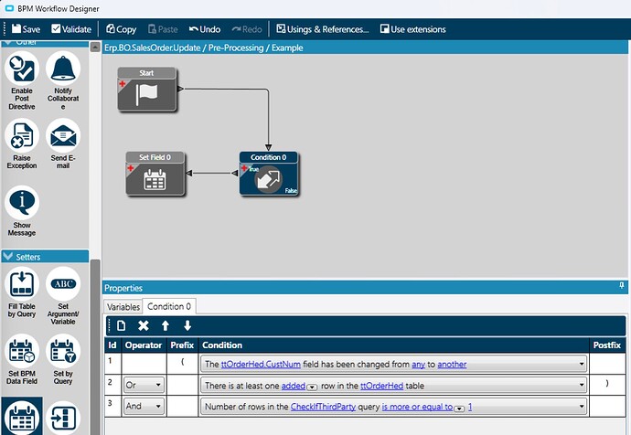

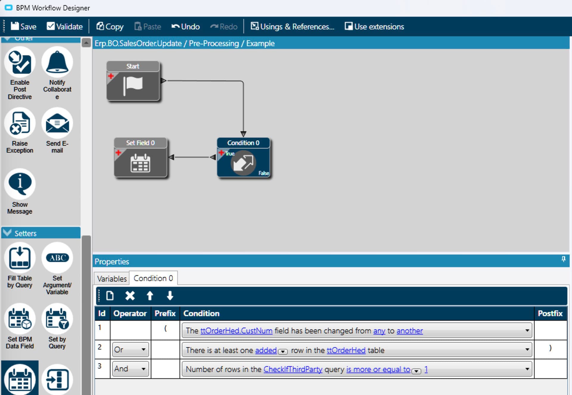

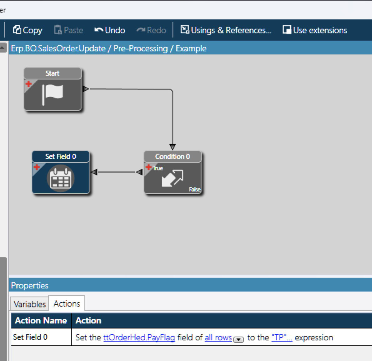

I’d probably do something similar to this:

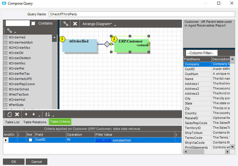

The query looks like:

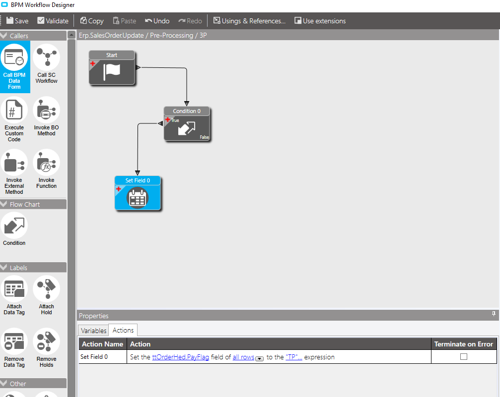

This determines if TP should be set, then this sets it.
Note, I say all rows because experience has shown that changed row doesn’t include added rows (though you would think it should).
You can further refine this to look at the billto if that also can control it and even issue the popup message if you want.

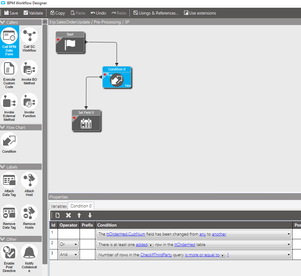

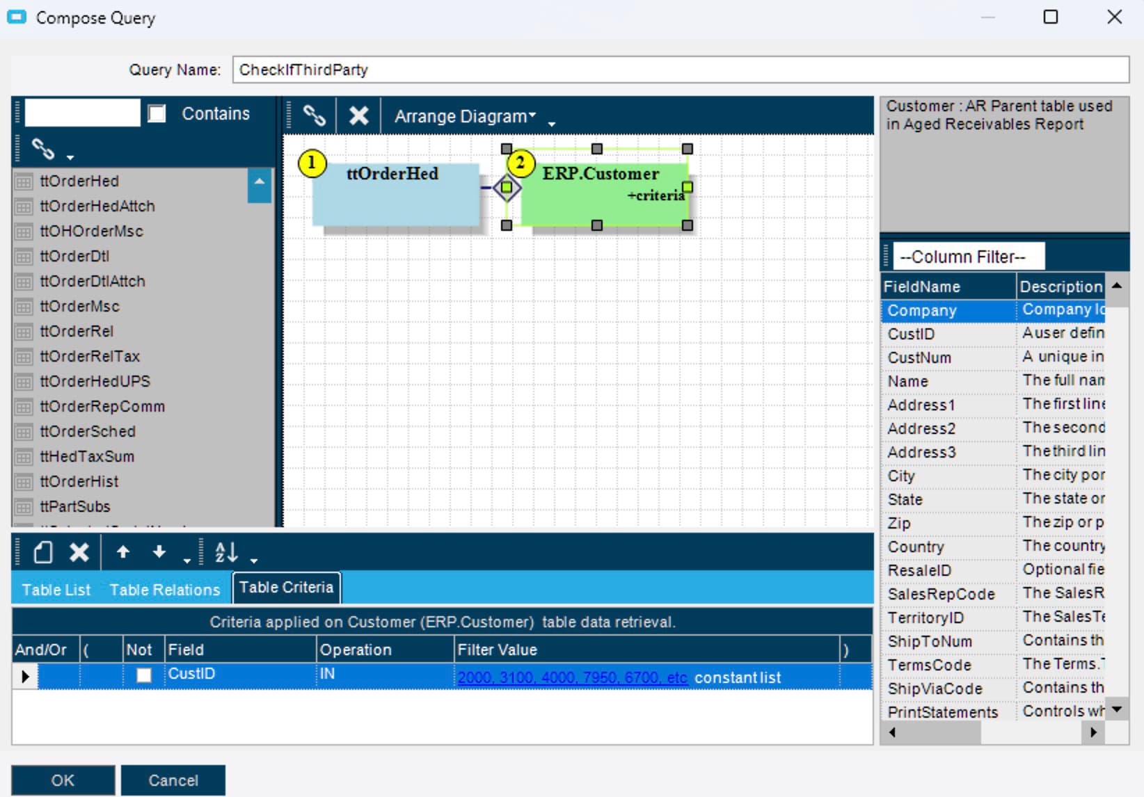

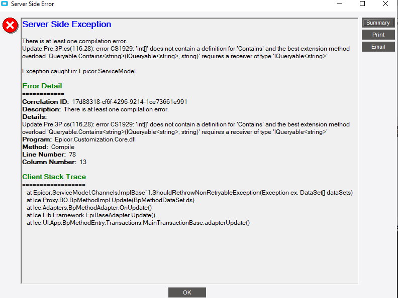

Hi Marjorie,

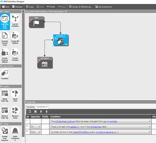

I followed your setup for a Method Directive on SalesOrder.Update. I receive this error. In my query ttOrderHed and customer are linked by CustNum. 3P is the name of the Method Directive I created.
Here is my setup:
Do you have quotes around the customer IDs?
