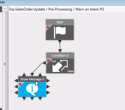

We have a warning on Order Entry when the ProdGrp of a OrderLine is blank.
Here’s the details:
It’s a Pre-Process on the Erp.SalesOrder.Update method

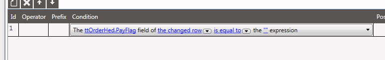

The condition is:

I believe changing the “Show Message” block to a “Raise Exception” one, would give you the stop you want

The combo of PayFlag and ShipVia is easy in the BPM, but will get tricky to maintain.
You can add a bunch of lines to the condition like:
1   The ttOrderHed.PayFlag of the changed row  is equal to ""
2  AND ( The ttOrderHed.ShipVia of the changed row  is equal to "shipviacode1"
3  OR    The ttOrderHed.ShipVia of the changed row  is equal to "shipviacode2"
4  OR    The ttOrderHed.ShipVia of the changed row  is equal to "shipviacode3"
5  OR    The ttOrderHed.ShipVia of the changed row  is equal to "shipviacode4"
6  OR    The ttOrderHed.ShipVia of the changed row  is equal to "shipviacode5"  )
