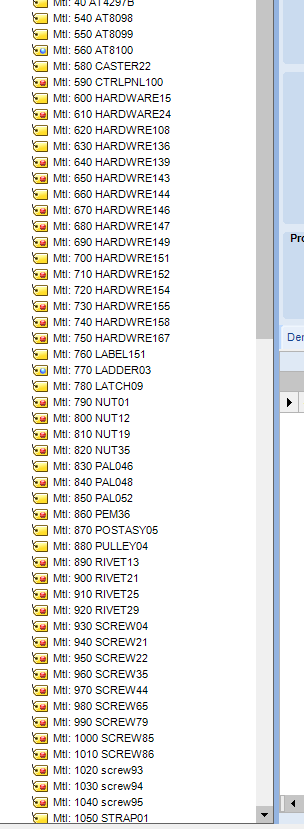

I was wondering how I would go about (if possible) to remove the red dot icon in the job entry tree for parts we have set to non-qty bearing ? All I could find is a table JobMtl that has a ShowStatusIcon column. I am comfortable with SQL but I have been told not to do any direct work in the SQL database, could I do this through Epicors customization ?

I was just using a screw as an example for a non-qty bearing part that we order, and since they never have to worry about it being out of stock they want me to remove the little red icon that appears once Epicor declares the part as being out/low. If I set the fixed qty to 0 and make it a reference material, will the red icon stop appearing ? For example, in the picture they want the screws to stop displaying the icon

Yeah so if you set it as fixed qty and leave the value at 0 it will give it a blue dot instead like an info marker.
But there’s not system constraints.
