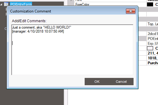

Customizations has built in “Notes” system that launches a pop up containing notes for that customization, like:
When a user clicks OK, it adds their user ID and time stamps it.

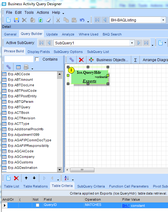

Calvin, here are a few BAQ designs I created to document custom features. First, BAQs:
Here menu customization finder…

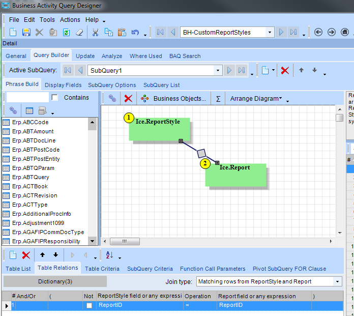

No problem Calvin! Here’s one last one, that finds custom report styles.
