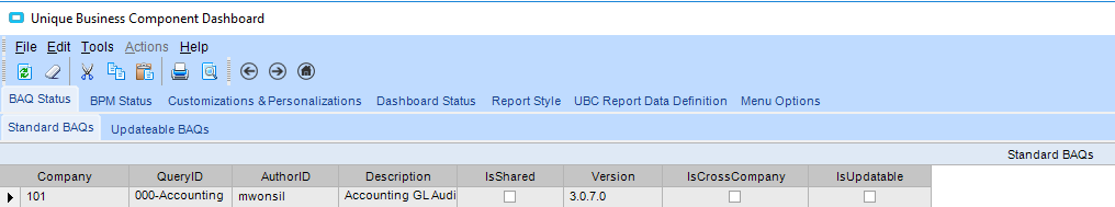

It doesn’t include the UD fields but there’s a Unique Business Component Tracker since 10.1. that shows BAQs, BPMs, Report Styles, Menu, items, etc. Not sure if it’s a SaaS-only thing though.
Solutions are a good way to keep most customizations too…
Mark W.
We run E10.1.600.8 using on site servers. This feature is not available to us but it looks really good. Is there any way to get it?

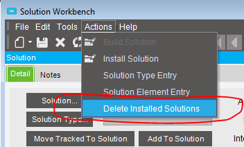

Horribly named but if you use Solution Workbench with solutions as your change management system you can look at all installed changes:
Just don’t delete anything but it will show all changes.
Safe Harbor
We are looking to change that to View with an optional Delete UI Pattern but no roadmap for that ease of use to reduce confusion.

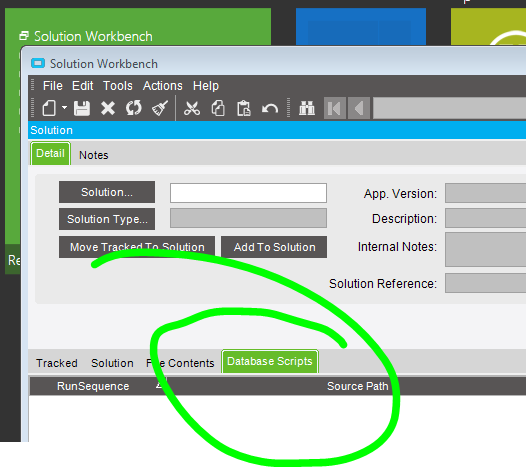

It depends on which data you are discussing. If you are discussing ‘seed data’ for the apps modules - that’s still manual unfortunately. We do support vanilla SQL scripts now in 10.2 though:
This allows you to leverage any data tools you have to ‘diff’ dbs and packages them as a sql insert script. ( I personally like Redgate but any should be fine). Review in help @ Solution Workbench > Detail > Database Scripts
